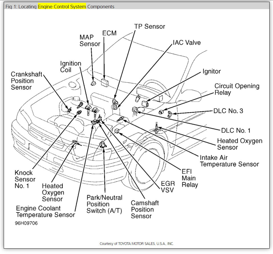

Where is the speed sensor located on my 1996 Toyota Tercel automatic? The mechanic says I could replace it myself easily but will not tell me where to locate it in the car itself.
Saturday, September 6th, 2008 AT 11:13 PM
KEN L
  • MASTER CERTIFIED MECHANIC
  • 55,291 POSTS

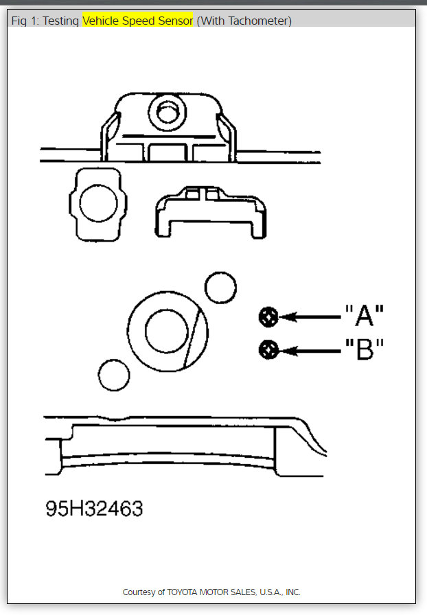

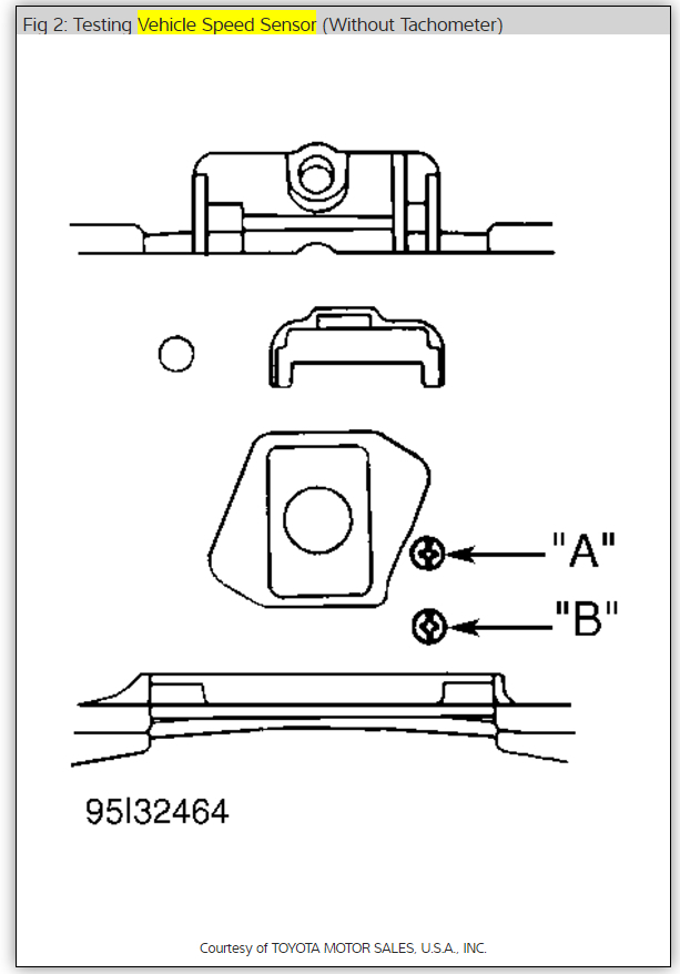

The sensor is located at the rear of the instrument cluster. You will need to remove the cluster to get to it.
Here are some diagrams (Below) that will help you get the job done.
