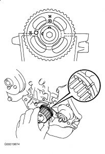

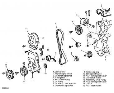

1992 Toyota Tercel timing marks for belt
ROBERTTOMASKIN
MEMBER
1992 TOYOTA TERCEL
Engine Mechanical problem
1992 Toyota Tercel 4 cyl Four Wheel Drive Automatic
103100
Sunday, April 11th, 2010 AT 8:54 PM
BLUELIGHTNIN6
MECHANIC
16,542 POSTS
+1
Sunday, April 11th, 2010 AT 8:58 PM
