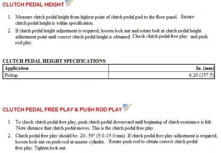

How do you adjust the clutch, I am pushing the pedal thru the floor board to change gears.
