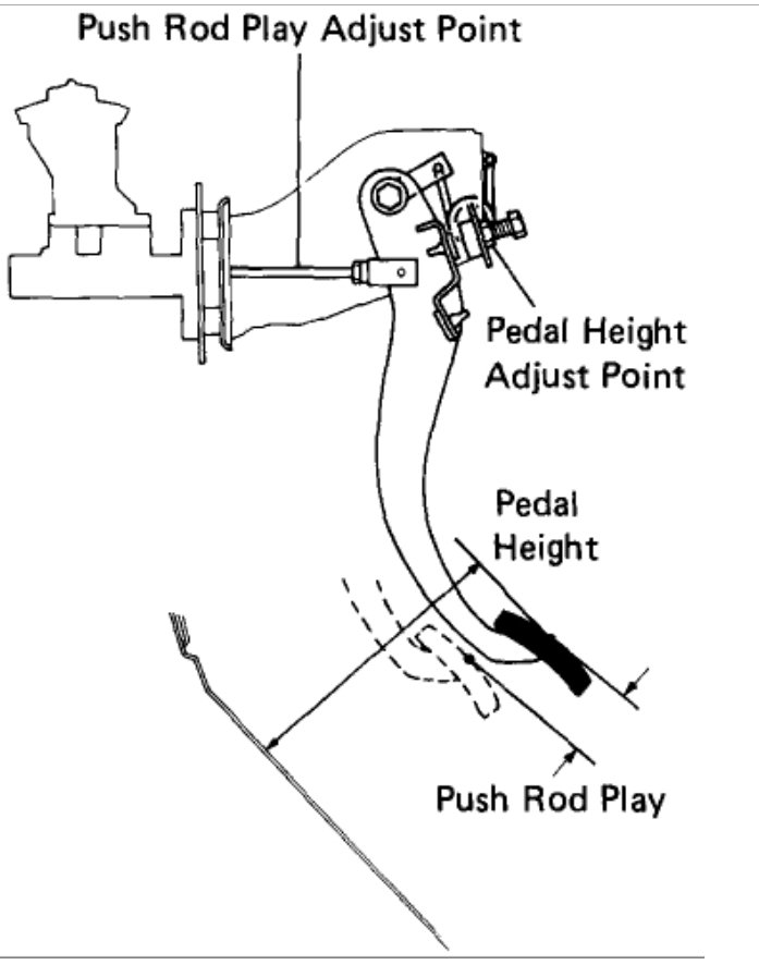

Clutch was not fully disengaging. Found I had a leaking clutch hydraulics; fluid level was low. Filled and bleed hydrualics. No change. Replaced Main and Slave. Adjusted under dash to max on main cylinder arm. Where is adjuster on oor near slave? I see nothing to adjust on slave. Clutch still does not fully disengage. Have to start car in gear. Can shift when running.

There is an adjustment but it is up at the clutch pedal. Loosen the jam nut and wind the push rod out a turn or so then recheck the pedal travel.
