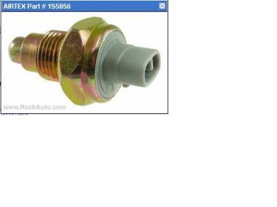

Recently my back-up lights have stopped working on my wife's truck.
I checked all of the fuses, cleaned the sockets, bulbs & connectors. Still no power to the rear contacts.
I attempted to replace the backup switch on the trans and I was send a part from Rock Auto that does not appear to match. The rep on the phone @ Rock Auto disagrees. I have attached a pic of their part that I cannot seem to find a place on the tranny for.
The dealer took the VIN # and told me there was NO separate backup switch for the automatic trans and I needed a neutral safety switch instead (@ 10x the cost).
Can you tell me if this model (Tran # 03-71) has a separate B/U switch from the NS switch?
Can you send me a pic with the location?

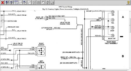

With a column shift

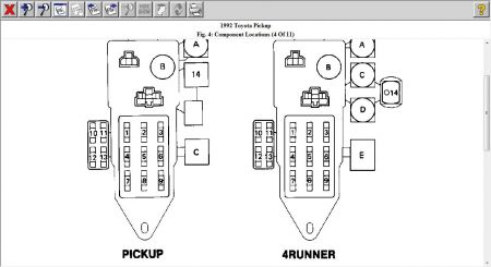

As per the back-up light-test the back-up relay-see below -Check A and no.14 for pick/up in the fuse/relay block no.1
If unreadable give me your email addy

Can you tell me if this part is valid for my auto trans?
Should I send it back?

Dunno it sure don't look like a relay-
I've sent the EWD
