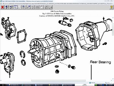

I can't find where to add transmission oil on this vehicle. Can you tell me how and where I can add transmission oil?

It's on the side of the tranny, just a screw in plug, drain is on the bottom, fill to bottom of the hole!
Gear oil!
