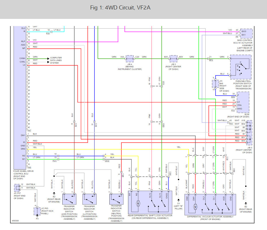

Hello gentlemen,
This is my first post on this site that I just discovered.
Here, I have a Toyota 4WD hILUX, code model: GUN125L-DTFMH, manual transmission, Engine: 2GDFTV.

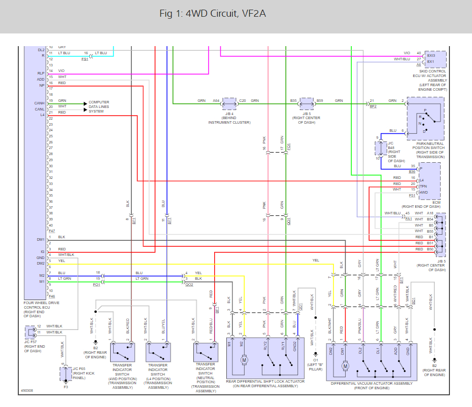

Recently, I had a totally unexpected problem just wanting to try the 4LO. I did not even move from my parking spot that I noticed on the dashboard, the orange indicator on the 4LO flashing at the same time that the ABS that remained lit continuously. I insisted to unlock and return to the switch H2-L4H-4LO but nothing to do, the transfer box was stuck on the 4LO. What I did, I deactivated the 4LO manually by intervening directly on actuator assy transfer shift to put the transmission in H2. Following this, I changed the actuator assy shift transfer by another brand new one. I thought naturally that the failure came from this organ but it is not! the problem has always remained as it is. and now I have the following error codes:
C1268
U0114
U0122
P17AC
What to do? could someone guide me please?
I thank you in advance.
PS: sorry for my average English because I speak French. :)
May 29, 2019 at 8:33 AM
  • 54,494 POSTS

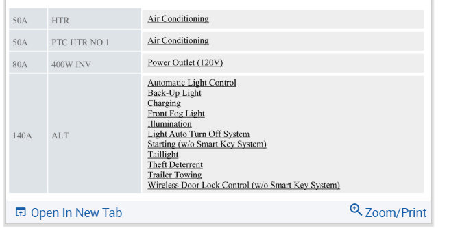

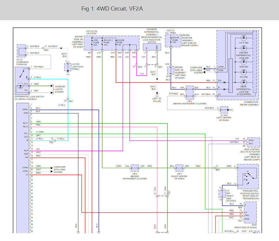

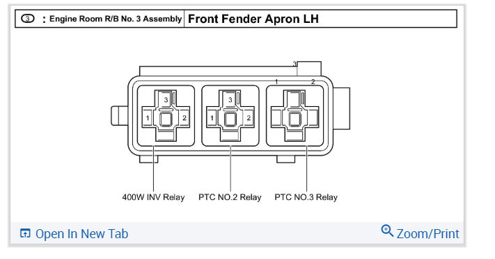

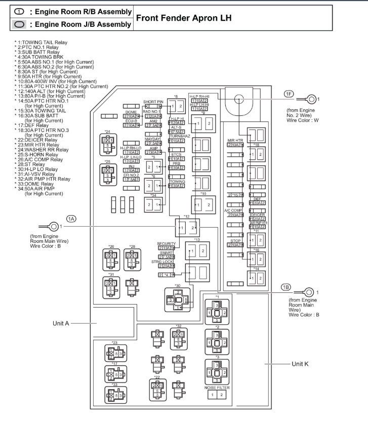

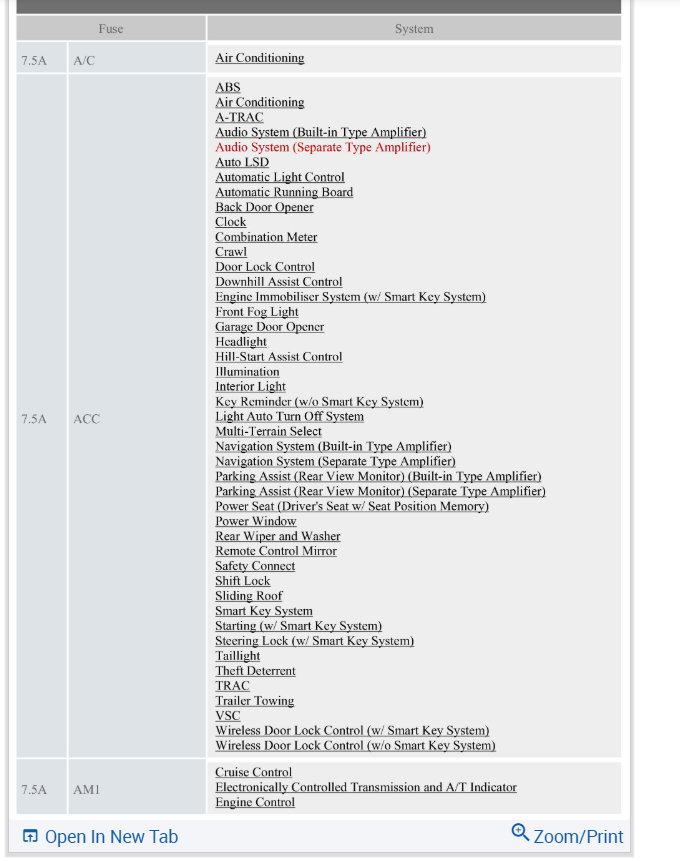

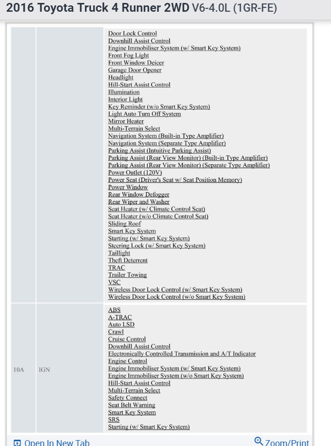

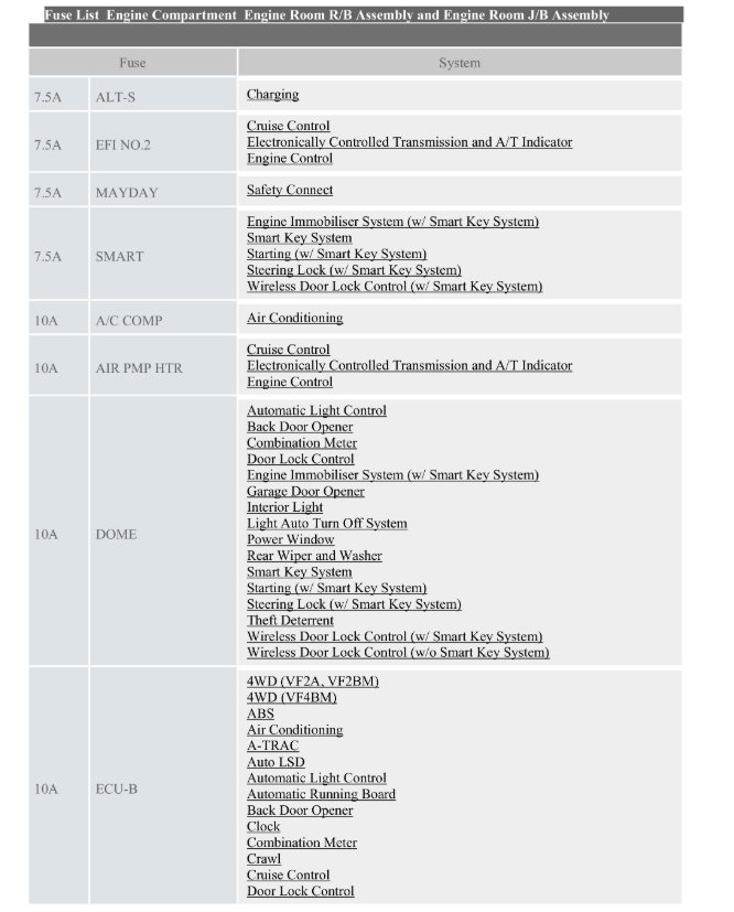

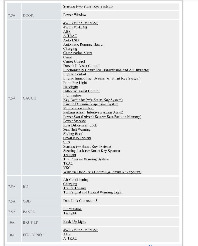

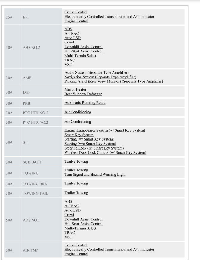

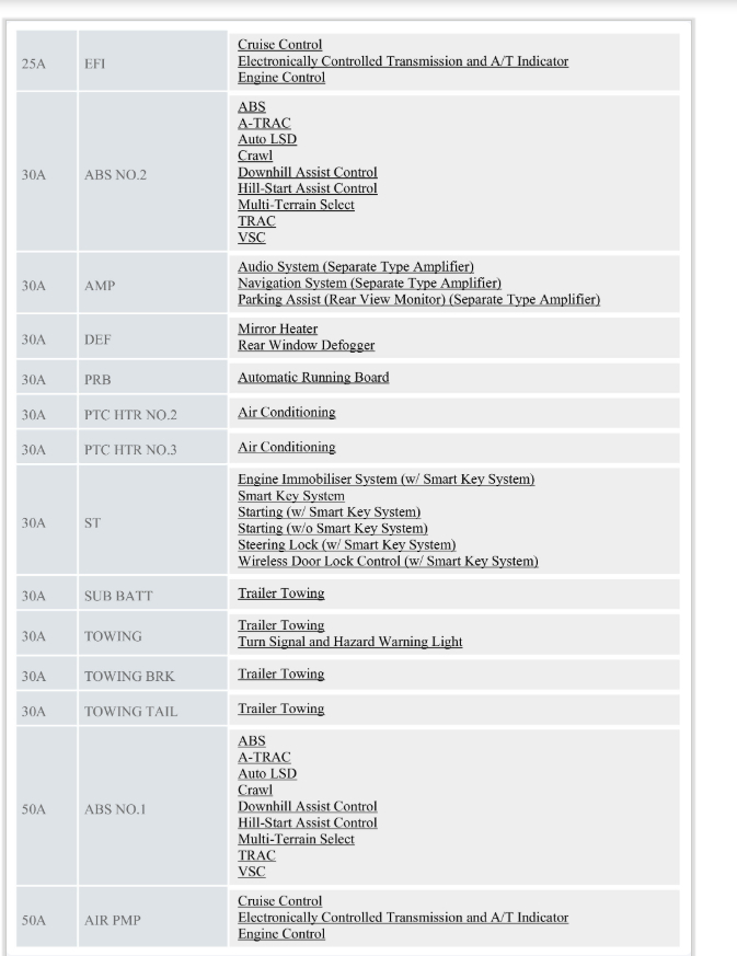

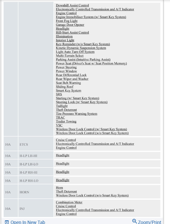

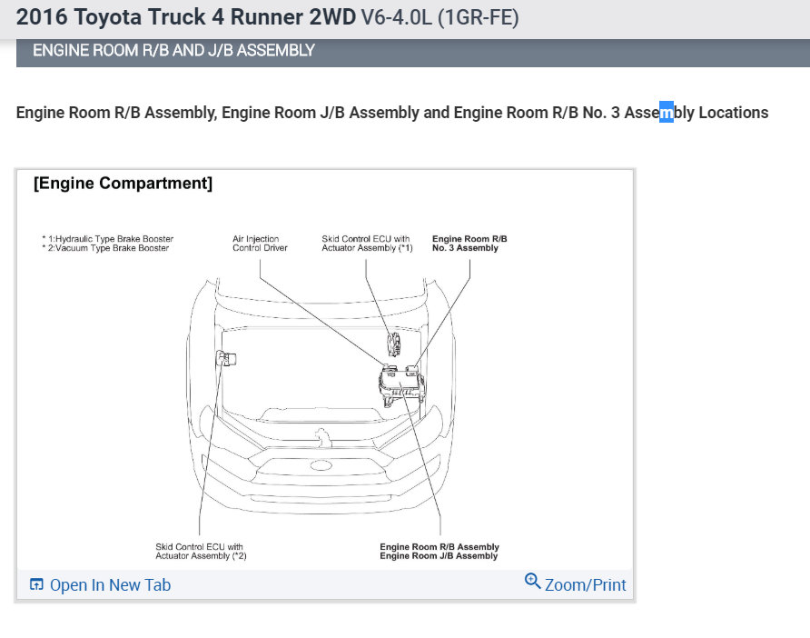

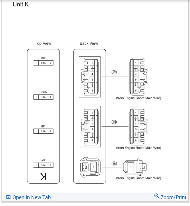

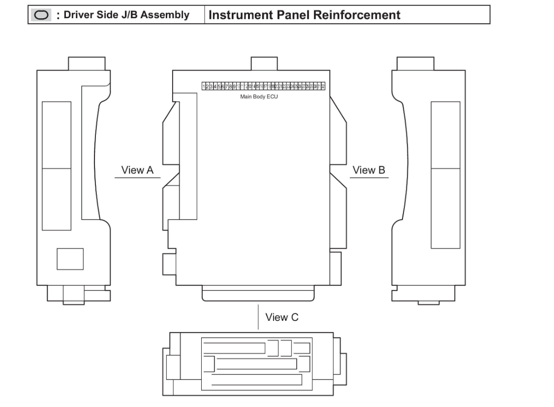

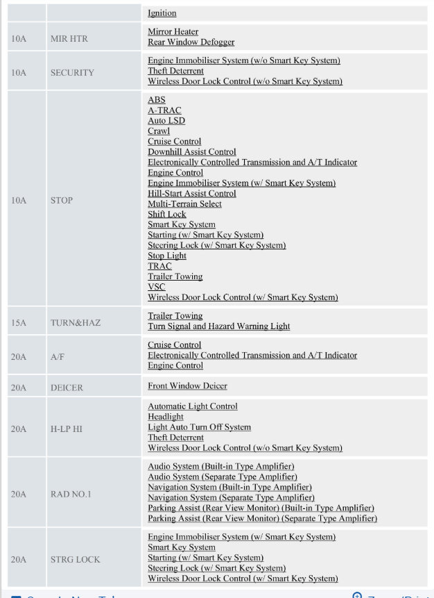

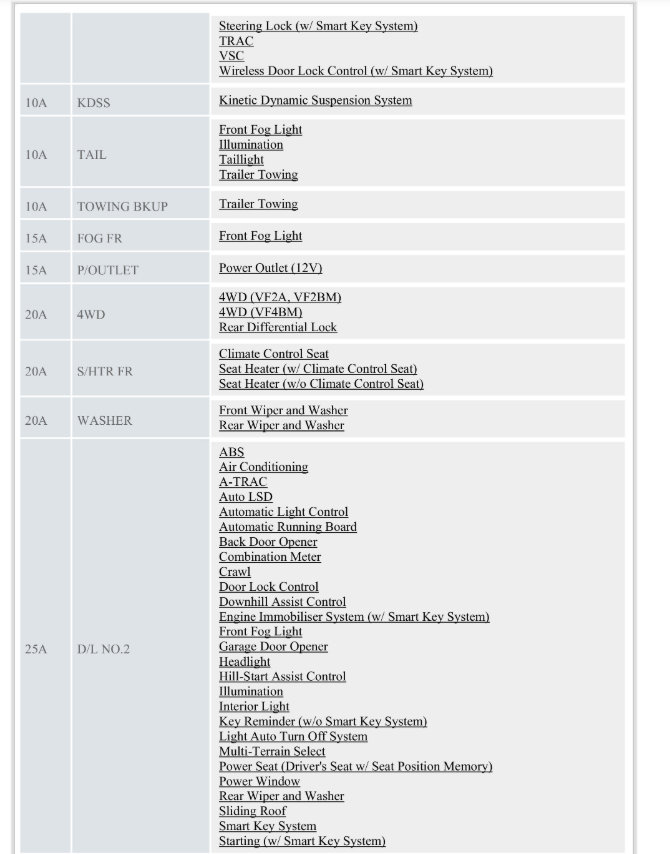

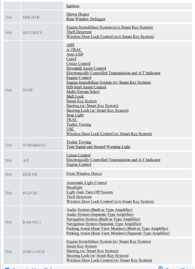

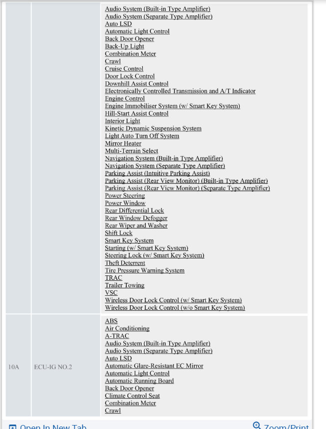

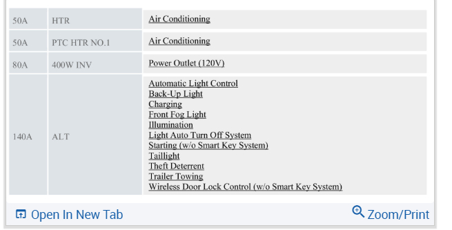

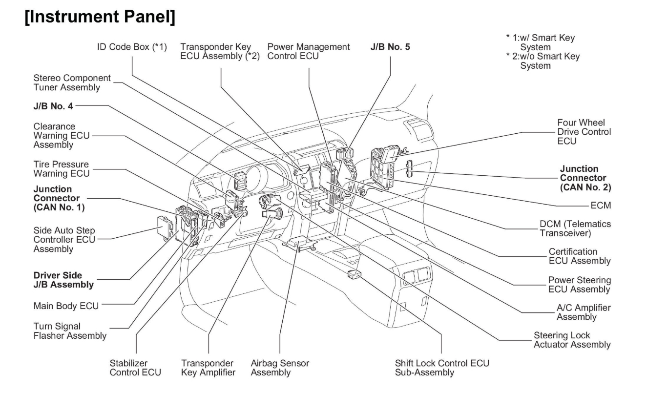

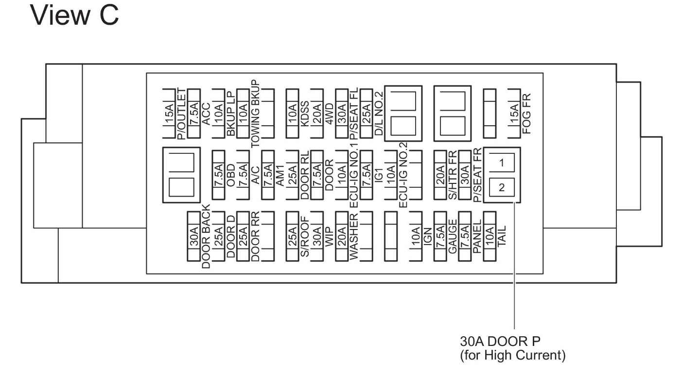

The codes and this problem is related to one of the modules shutting down. Could just be a fuse. Lets start by following this guide and check the fuses. I have included the fuse panel location and identifications along with the 4wd transfer case wiring diagrams so you can see how the system works.
Check for power at the fuses as well. Check out the diagrams (below). Please let us know what happens.
