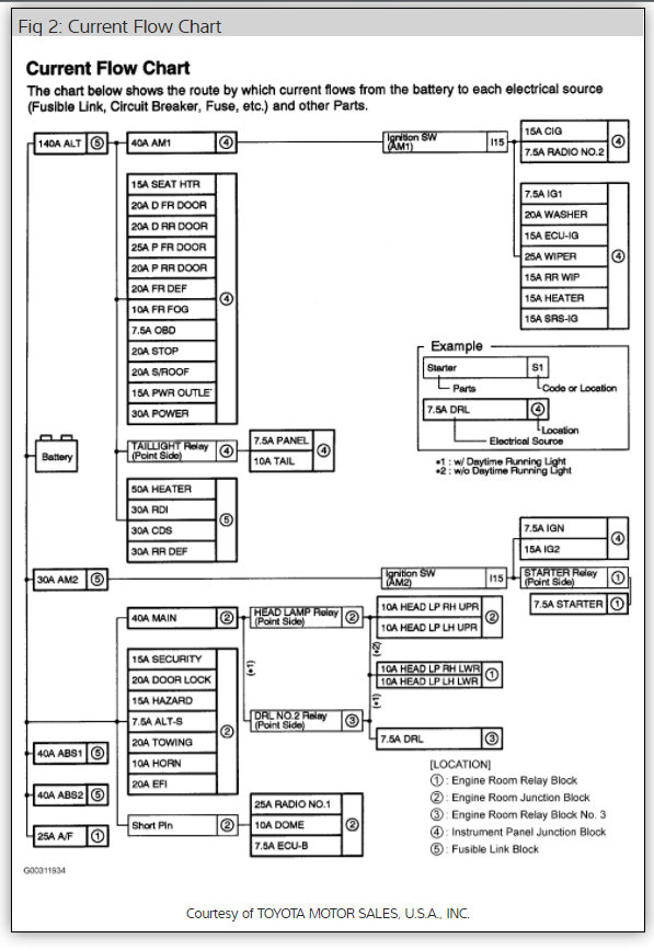

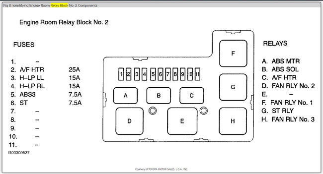

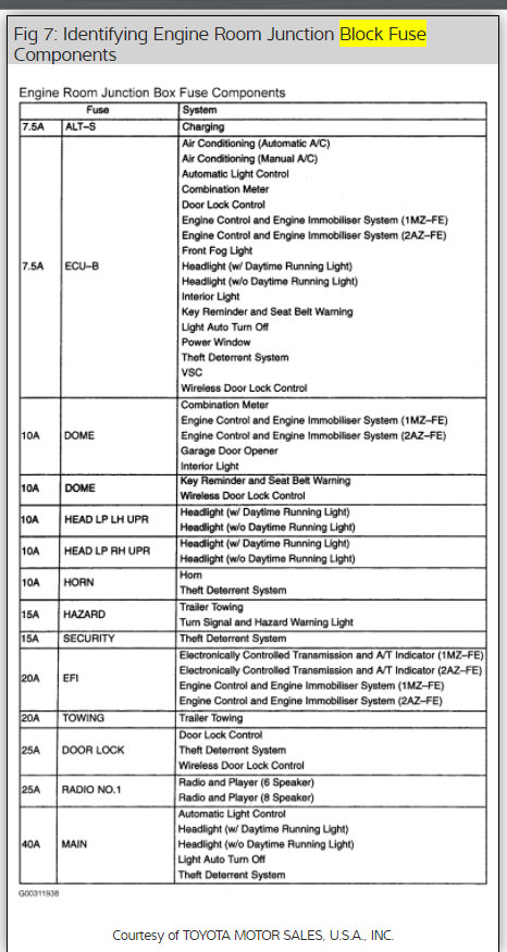

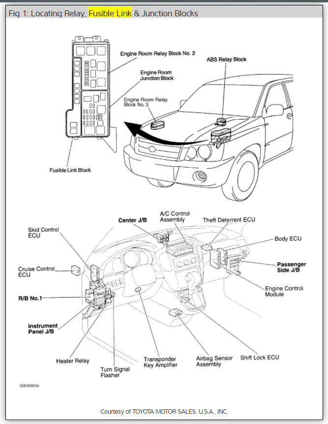

The clock, AC, and Air circulating button light don't work, and none of the three work.
May 31, 2009 at 7:17 PM
  • CAR REPAIR CONTRIBUTOR
  • 54,308 POSTS

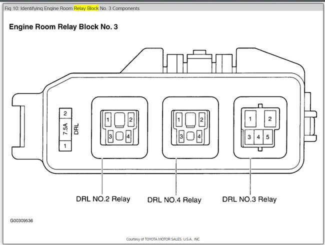

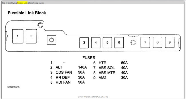

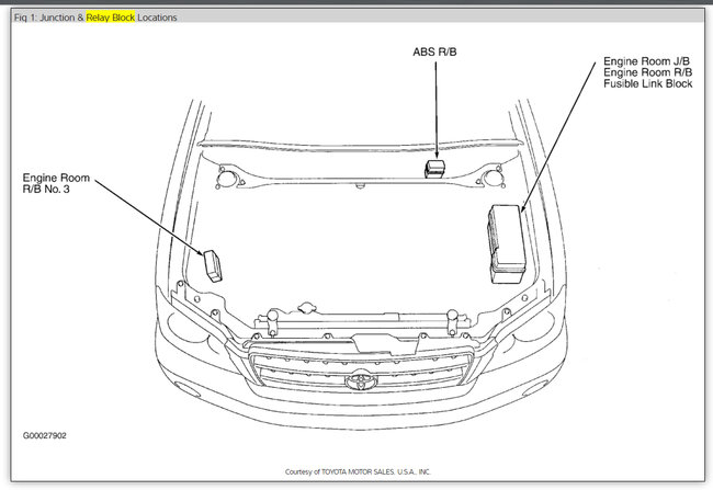

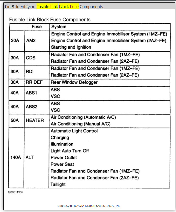

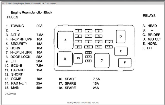

It sounds like a fuse has gone out, here is a guide and some diagrams (below) that will help you get the problem fixed.
and
Please let us know what happens, we are interested to see what it is.
