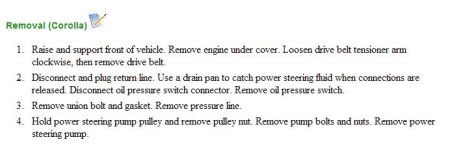

I Need to know how to replace power steering pump

Once finished be sure to check front end alignment..
