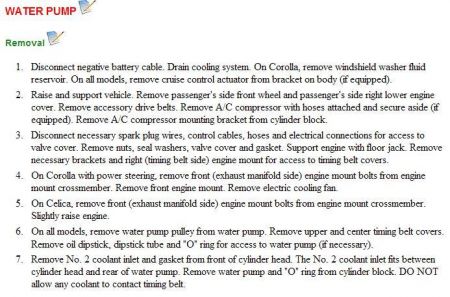

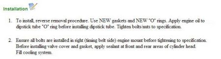

How can I remove the wate pump and where in the engine is located at

Monday, July 27th, 2020 AT 4:41 PM
