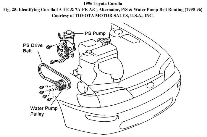

I am trying to loosen power steering reservior in order to remove old belt for replacement. But there are one belt on the top and three belts at the bottom. Which two are pivot and lock bolts that I have to loosen please? Any help highly appreciated! Thank you.

You have to loosen pivot bolt and the PS mounting bolt at base of PS unit, it can be hard to get to, remove RF tire and stone guard for better view.

Thanks for your help! It's 1.6L, and your uploaded picture is a view of the generator. What I have no clue is the pivot and mounting/lock bolts for the power steering pump. There are about 4 or 5 bolts on the back of the P/S pump, and I don't know which ones to loosen. Any more help highly appreciated!
Apr 15, 2009 at 7:11 AM
WANGZHE18
Thanks for the help, mmprince! Which one are the pivot the PS mountin bolt please? There are several back there, and I don't know how to identify. Million thanks!

https://images.2carpros.com/forum/automotive_pictures/261618_1_47.jpg
Tension on the power steering belt is adjusted by means of an idler pulley (some models may use just a lower adjusting bracket setup-similar to alternator adjustment service procedure). Loosen the lock bolt and turn the adjusting bolt on the idler pulley until the desired tension is felt and then tighten the lock bolt.
Apr 15, 2009 at 10:30 AM

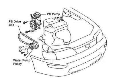

Is it feasable to replace a broken power steering belt on my car if I am somewhat mechanically inclined? I have worked on my Ford truck so I am better with American cars. Or should I just head to a service station? Is this a job that can be done in my driveway?
Feb 17, 2018 at 1:37 PM (Merged)
MHPAUTOS
  • CAR REPAIR CONTRIBUTOR
  • 31,937 POSTS
Hi there,
It is possible to replace it in the drive way, you will have to jack it up and remove the wheel, as this will make the access to the pump bolts easier, have a go you should be ok with this.

I want to replace the steering belt because of squeaking sound & found out that it is already sliding when I turned the wheel to the fullest right & left, do you have a video of how to replace it?
  • 54,352 POSTS
Hey HENRY
That is not to bad of a job, here is a diagram that will show you what you are in for.
https://www.2carpros.com/diagrams/toyota/corolla/1994
Please let us know happens so it will help others.
Best, Ken

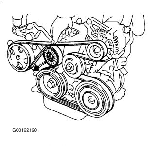

I want to know what is the easiest way to change the belt with air condition unit by myself. Please show me the way to change it.
thankyou very much
MMPRINCE4000
  • 8,548 POSTS
Move tensioner pulley (arrow in picture) to release tension on belt, then remove belt. Buy a good belt, Dayco, Gates, Goodyear, Toyota. Use brake clean to remove any contamination from pulleys, make sure pulleys are tracking properly.

DEEPBLUESEA1226
  • 7 POSTS
I found the tensioner pulley, but I couldn't push it down like the photo shown. do I need some tool too release the tension?
Feb 17, 2018 at 1:38 PM (Merged)
MMPRINCE4000
  • 8,548 POSTS
A tensioner tool is available from most autoparts stores for rental.
Try a socket on a long ratchet.
DEEPBLUESEA1226
  • 7 POSTS
thank you guys.. I finally got the belt out.
MMPRINCE4000
  • 8,548 POSTS
Great news.
Make sure to inspect pulleys and clean with brake clean. Brake clean dissolves grease, grime, coolant and leaves no residue.

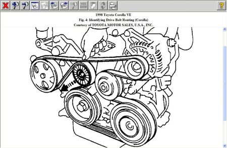

Engine Mechanical problem
1998 Toyota Corolla 4 cyl Front Wheel Drive Automatic 135000 miles
How do you go about replacing the serpentine belt on a Corolla?l
KHLOW2008
  • 41,814 POSTS
Hi gulf81star, The Auto tensioner has a 19 mm hex head which you can use to release the tension to remove the belt.
https://images.2carpros.com/forum/automotive_pictures/192750_SerpentineToyota98_1.jpg
