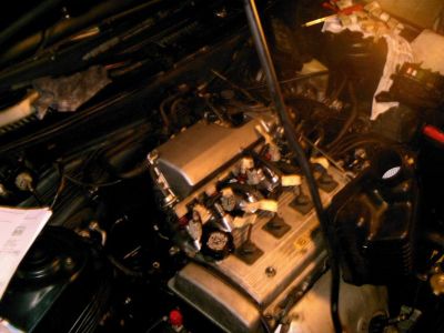

Thanks for your response. I checked for charred cable or leak from the exhaust; no luck. I have been tracking the cables : black with red( AM2) and black with orange( to the injectors). I have been tracking the AM2 from the fuse box onwards. I have been tracking the injector cables from the injector side onwards, and from the ignition side onwards. have not had any luck so far. i am stuck since I have almost eliminated every circuit. ps. disconnected every relay and fuse except the one I mention below. tested injectors and they have the resistance shown in repair manual disconnected EVERY fuse( except the three big ones: AM1-start,airbag-, ALT100A-tail,stop,ECU-B,AM1,ABS- ,and ABS50A -abs- )and it blew again. Starter and alternator are new. I changed them. I wanted a reliable starter and alternator(that is when the car starts).
https://images.2carpros.com/forum/automotive_pictures/370042_toyota93Engine_1.jpg

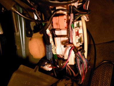

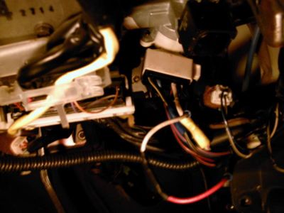

Ign switch and fuse box inside
https://images.2carpros.com/forum/automotive_pictures/370042_Toyot93IgnSwitch_1.jpg
https://images.2carpros.com/forum/automotive_pictures/370042_Toyot93FuseIn_1.jpg
