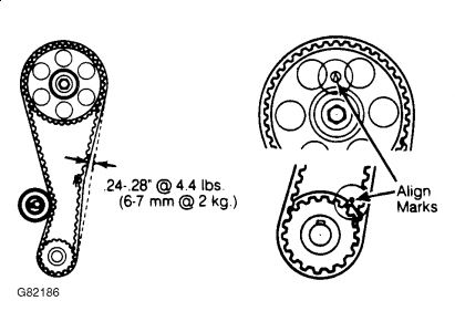

I just replaced the timing belt in my car and now she won't start. Is there anything I can do?
Monday, May 18th, 2009 AT 11:30 PM
MMPRINCE4000
MECHANIC
8,548 POSTS
Yes, you probably installed belt out of time, remove belt, align crankshaft timing marks, then camshaft timing marks, reinstall belt.
