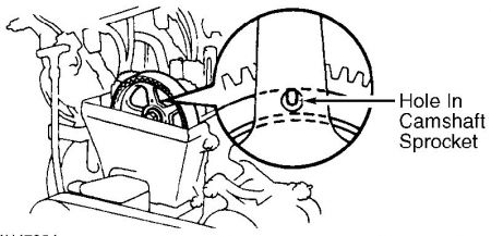

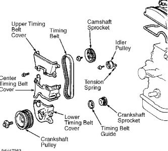

I have Corolla 97 1.6L
the question is if somebody know how to change the timing belt and water pump?
maybe someone has a guide how to do it?
Thank you!

Ok but how to do it. Do you have the points. Like the first what I need to do, after that the second thing.
Thank you! I really appreciate your help!
Monday, November 5th, 2007 AT 12:31 AM
MMPRINCE4000
  • 8,549 POSTS
It is best to buy a Haynes manual. You can pick one up at Advance Auto for $16.00. It has the complete procedure with pictures.
When you replace the waterpump (on some models) you have to lift the engine up to remove the waterpump pulley, so if you don't have a cherry picker or equivelent, you would need to rent one.
Also make sure the WP replacement has 2 Orings, one for the block and one for the housing.
