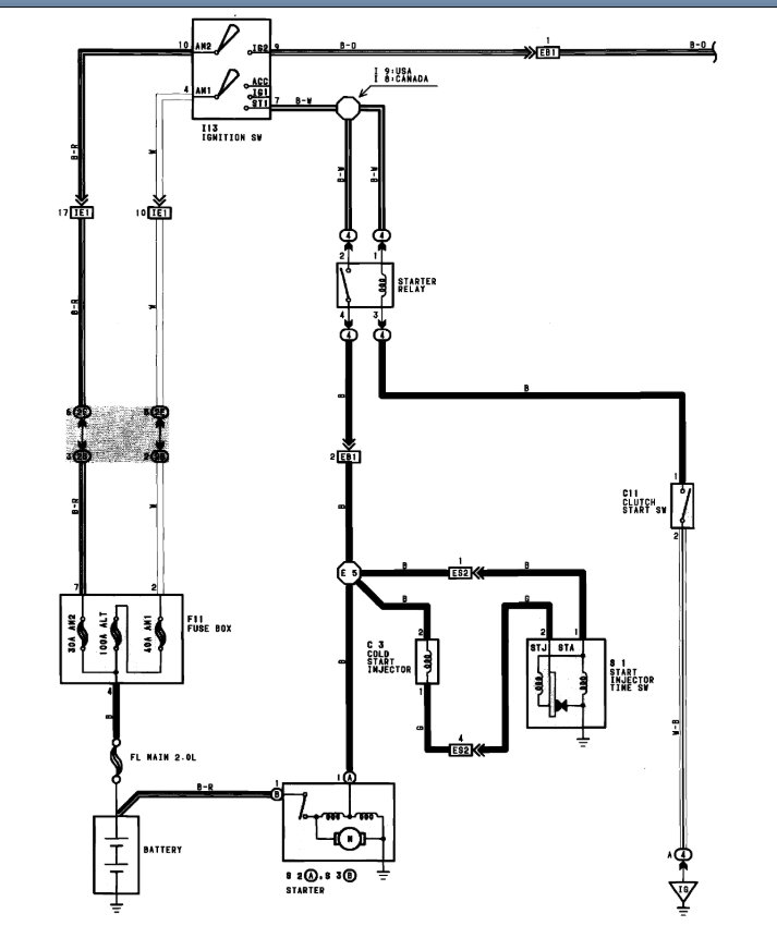

When I turn the key to the on position there is no electrical power. The only things that work are my fuel pump, headlights and hazards. The wipers, alternator, dash clock, radio, turn signals, and the a/C unit all do not work. All do not have power. I have tried new terminals, ground wires engine, main relay and it has a brand new starter. It is not the battery or terminals because the head lights and horn work to their full potential.

Hi snowboardpink14, Welcome to 2carpros
Lets check and test the fusible links in the fuse link box before and after the link. If all okay test the ignition switch and get back with some results.

I am having the same issue and I replaced the ignition switch and ECM and still nothing.

  • CAR REPAIR CONTRIBUTOR
  • 54,298 POSTS
It sounds like you are not getting power to the ignition switch. Here is a guide to help you check and the wiring diagram so you can see how the system works and which wires to test:

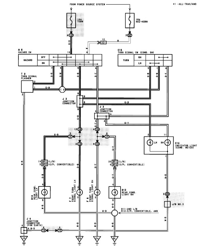

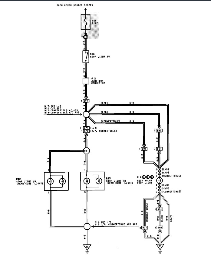

I am also having the same issue with my 92 Celica. The only thing working is horn, headlights and hazard. No turn signal, not even brake lights. I have checked the fusible links, and all are good. Please help.
  • 54,298 POSTS
Can you please check fuse (stop 15 amp) and fuse (Turn 10 amp) for power? here is a guide to show you how also I have included the turn signal and brake light wiring diagrams so you can see how the systems work:
