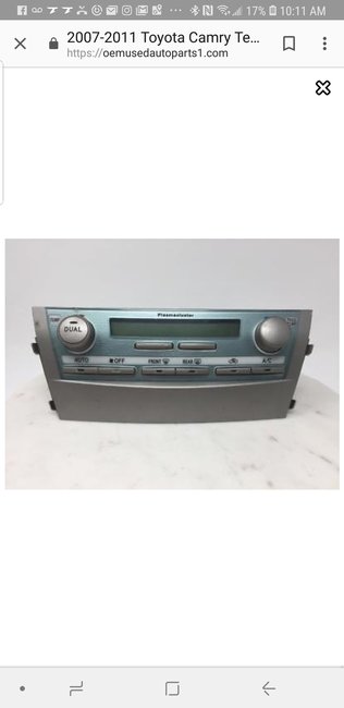

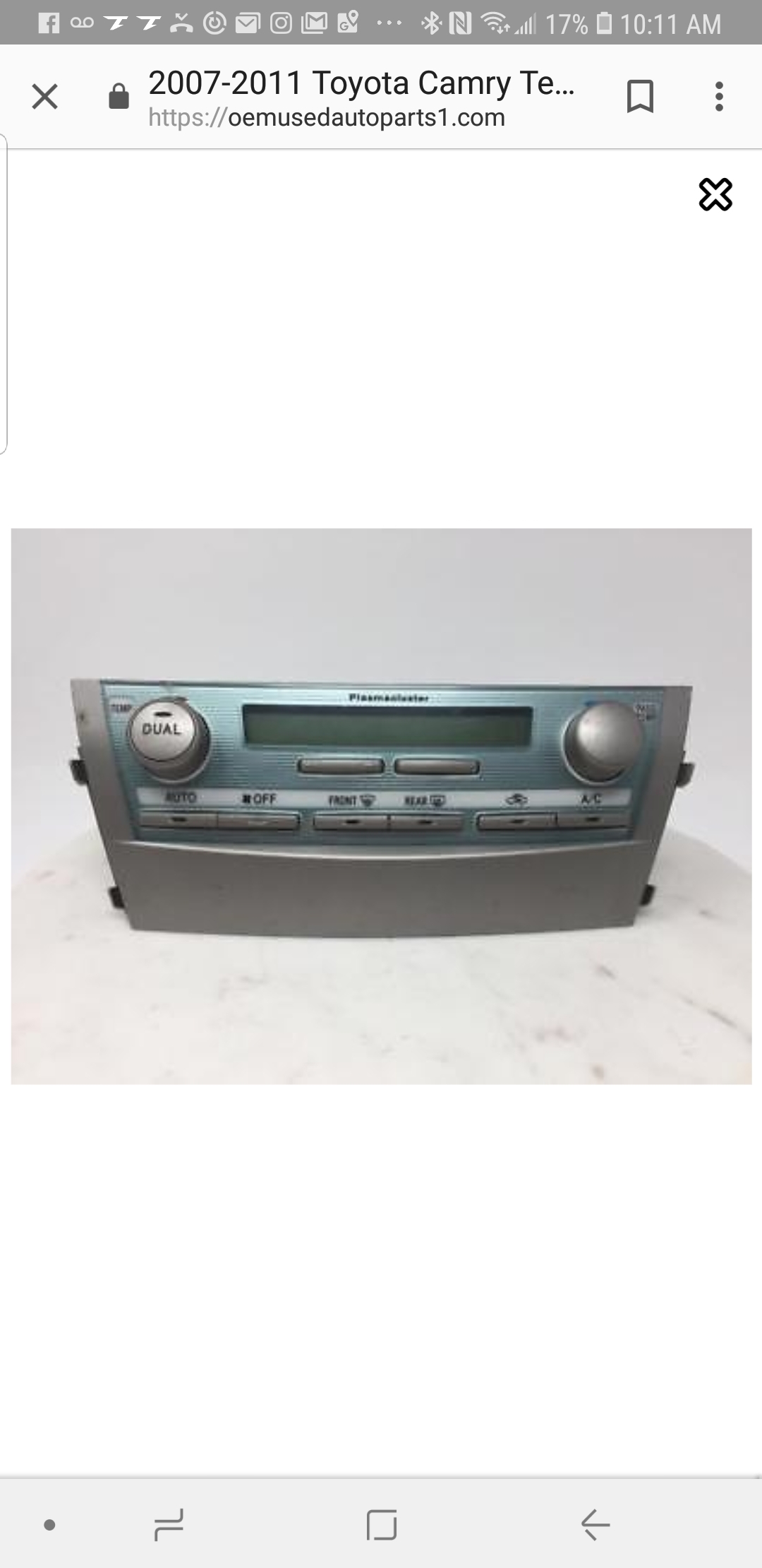

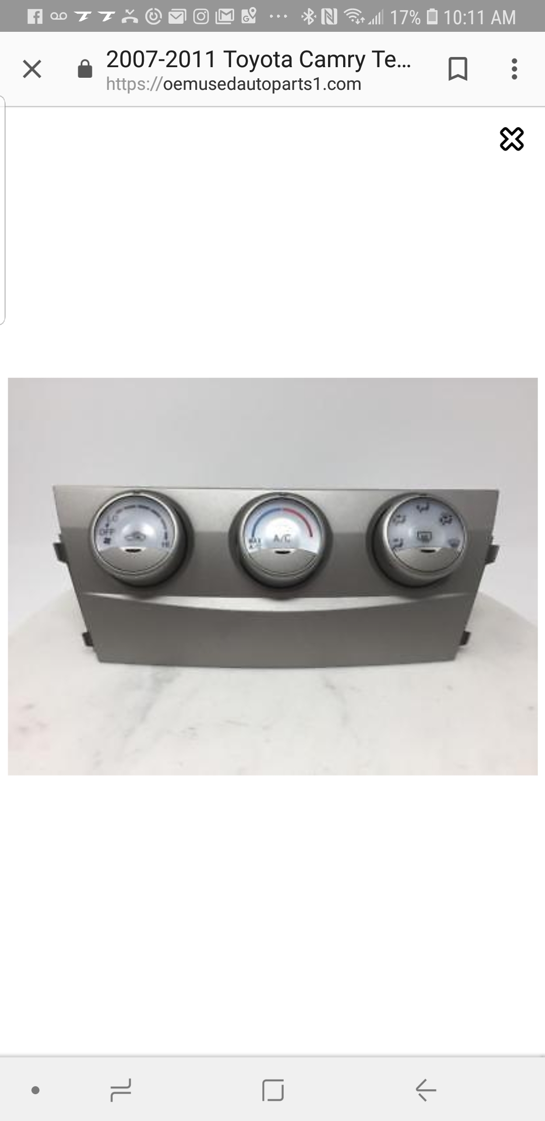

I have the car listed above SE model. I have always disliked the AC unit in those cars even though I love the car, but I always admitted the one out in the hybrid version (first Image attached), the present AC unit is the second image attached. I am about to purchase it but I am wondering if it would fit or function properly with the SE version. Thank you.

Why would you want to change control heads? Is there an issue with the functions?

I am someone who loves remodeling, I love redesigning things, I have been said to be doing things extremely. To be candid I just do not the present AC unit design, it is too analog, and the present AC unit works well.

They are different and the wiring is completely different. This would be a major undertaking with a wire harness, along with components a well.
Are you willing to take on this type of project as it will be huge?

No one I have ever spoken has done this. They just keep the OEM control head.
No, there will be harness changing and adapting to the existing harness as well as different components on the heater housing.
It is possible to do but there will be many hitches that will need to be overcome. Custom changes always have bumps in the road to success.

As Roy stated there is a lot of work plus you would need to reprogram the engine and body computers to make them stop showing errors as they communicate with the original control head for the automatic controls. You would also lose the dual climate controls and the automatic temperature system. The actual HVAC box is different as well so you would need to remove the dash to get to the various servos and controllers and determine how to rewire it all to work with the base level controller.
