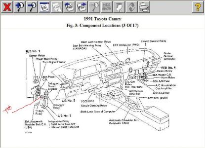

I noticed that I don't have any tail lights at all. I checked the fuse and bulbs and there fine, is there another fuse. Is there another place to check?
Friday, September 7th, 2007 AT 11:52 PM
  • 75,992 POSTS
You forgot the tail light relay see below
http://www.2carpros.com/forum/automotive_pictures/12900_91_toy_camry_tail_light_relay_1.jpg
Hope this helps
