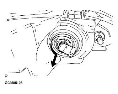

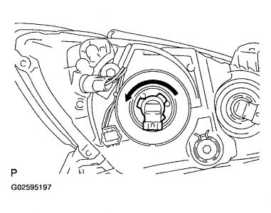

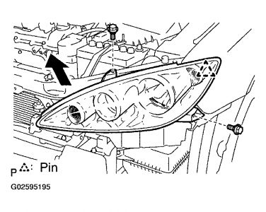

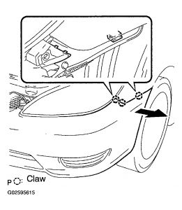

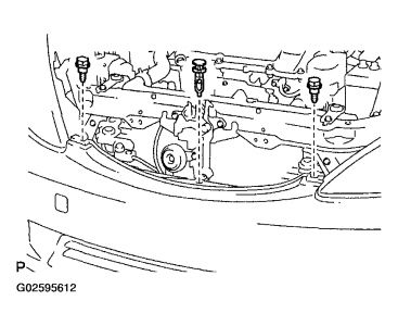

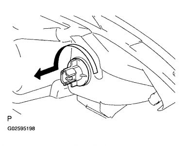

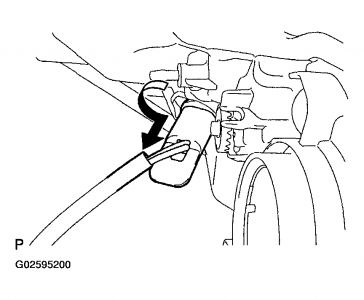

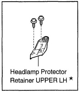

how to replace fron side marker bulb
Feb 8, 2009 at 5:01 PM
  • CAR REPAIR CONTRIBUTOR

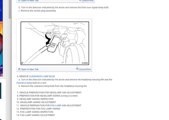

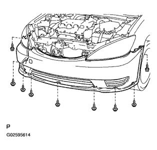

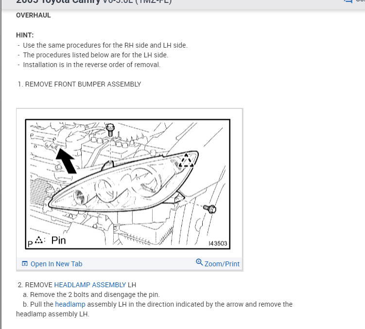

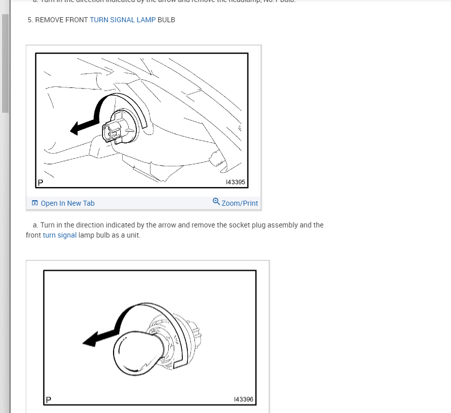

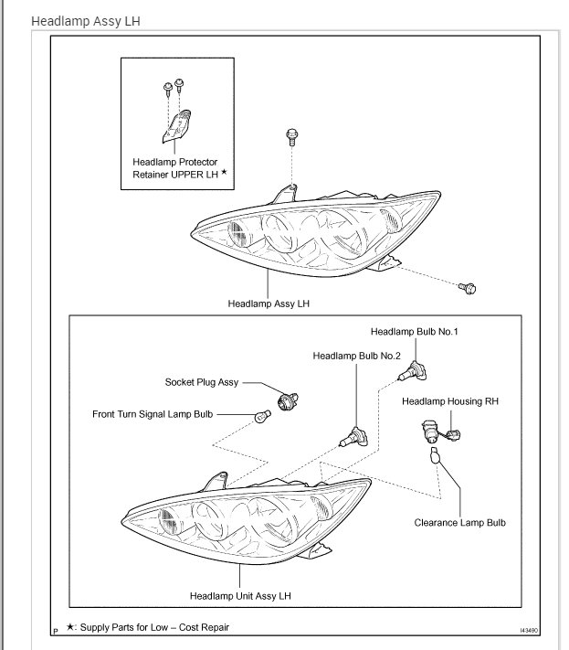

I am attaching the info from the manual below on the bulb replacements so please review this info.
Also, here is a guide that will help with some good info that may help:
https://www.2carpros.com/articles/drl-light-bulb-replacement
Please run through this info and let us know if you have other questions.
