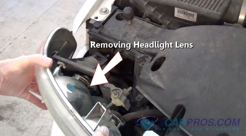

1. Remove Upper Lens
Locate the mounting pins or screws to remove the lens or inspect behind the lens to see if you can get to the bulbs without removing it. Each car is different and if you cant figure out how to get to the bulbs then a online repair manual is needed or you can check on Google images. In the example below the lens is held in by pins which are easily removed. This upper lens must be removed before removing the lower DRL lens.
remove headlight lens
After the retainers or screws have been removed grasp the lens and gently remove it from the lens mounts. There will be wires attached so be careful not to damage them.
removing lens

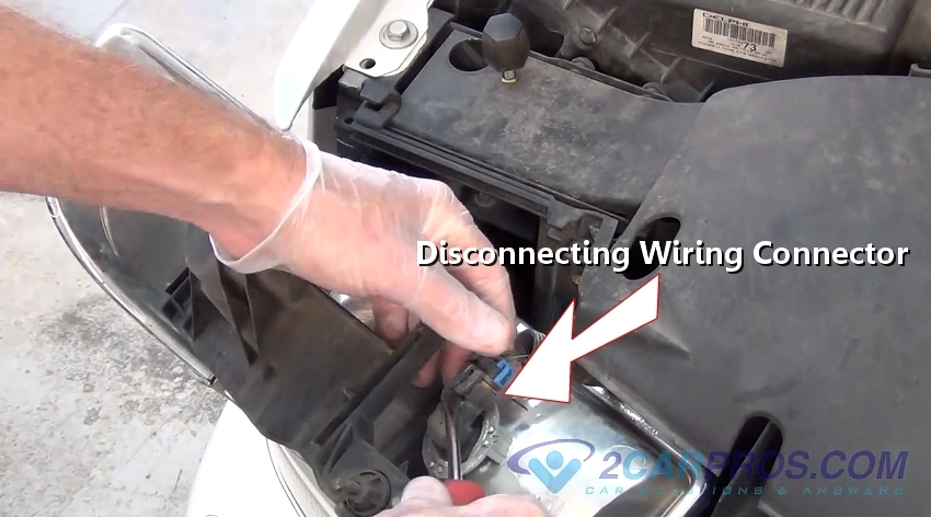

3. Disconnect Wiring
Use a small screwdriver or pick to release the wiring connectors by releasing the safety clips and pulling them gently outward. These connectors can be a little stuck because of the weather packing seal which is meant to keep water out of the connections.
diconnecting wiring connector

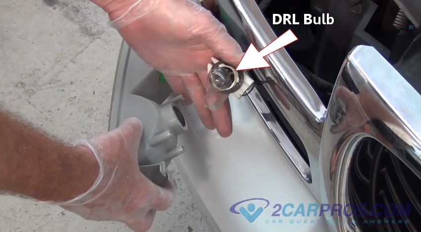

5. Remove DRL Bulb
Grasp the DRL light bulb socket and gently turn it counterclockwise to remove the bulb socket. This can be done by removing a clip as well which will depend on the design.
remove drl bulb socket
Once the socket is removed the DRL bulb will be exposed.
drl bulb
Gently grasp the bulb and firmly pull the bulb from the socket. The bulb is held in by pressure clips and they will release with a little pressure. Some bulbs you must push downward and turn counterclockwise to remove.

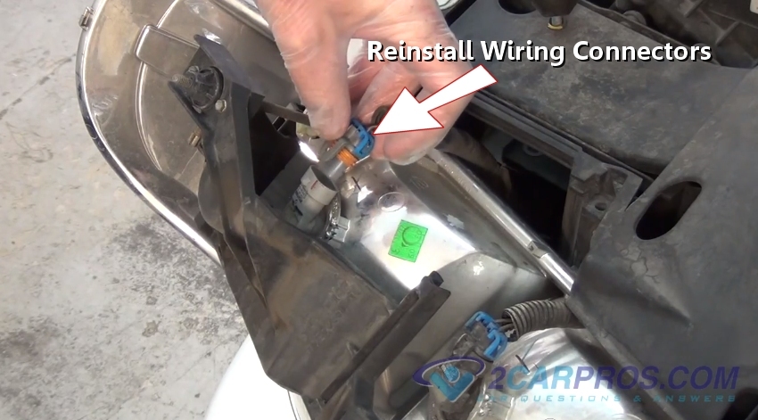

7. Reinstall Upper Lens
Once the DRL lens is in place reconnect the wiring connectors to the upper lens and reinstall into its mounts.
reinstall wiring connectors
Reinsert the retainer clips or screws and start the engine to activate the DRL bulbs to ensure their proper operation and you are all set.
