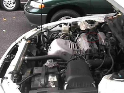

F4I_GUY
  • CAR REPAIR CONTRIBUTOR
  • 3,302 POSTS
Unfortunately it sounds like you should tow it to a shop. To fill up the oil, you remove the oil cap located on the valve cover. I have circled the area that the cap will be in red.
https://images.2carpros.com/forum/automotive_pictures/276698_toy_oil_cap_1.jpg
if you meant where to top up the transmission fluid, you will have to remove the red dipstick that is in the front driver side of the engine compartment. You remove the dipstick and the oil goes down that thick tube. Make sure the vehicle is parked on level ground when checking oil level. Also, to check transmission fluid level the vehicle must be turned on.
