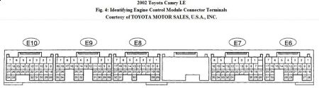

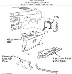

My check engine light comes up everytime the weather gets muggy, hot/humid, and rainy. But when the weather clears up the light goes away.
My coworker has a theory that it's caused by a dirty air filter not being able to pump the extra humidity through.
I've taken it for a free run of the computer, and the options were pretty varied on the problem, but essentially it all had to do with a filter. Any ideas?

I believe it was P0442, the one for the Emissions System.
And I did check the gas cap. It stayed on for a good 3 weeks originally a few months back and was fine until yesterday when the weather changed, again.

Here are the description and diagnostic procedures for the code. Seems the fuel tank cap is the most likely cause.
DTC P0440 & DTC P0442 : EVAPORATIVE EMISSION CONTROL SYSTEM MALFUNCTION
Circuit Description
Vapor pressure sensor, canister closed valve VSV and pressure switching valve VSV are used to detect faults in EVAP system. DTC is set if EVAP system leak is detected or vapor pressure sensor malfunctions. Possible causes are:

8. Access ECM behind glove box. See Fig. 2 . Turn ignition on. Using DVOM, backprobe ECM harness connector and measure voltage between terminals No. 18 (Yellow wire) and No. 28 (Brown wire) at ECM harness connector E10. See Fig. 4 . Voltage should be 4.5 - 5.5 volts. If voltage is not as specified, replace ECM. If voltage is as specified, go to next step.
9. Remove fuel tank cap. Turn ignition on. Using DVOM, backprobe ECM harness connector and measure voltage between terminal No. 21 (Pink wire) at ECM harness connector E6 and terminal No. 28 (Brown wire) at ECM harness connector E10. If voltage is 3.0 - 3.6 volts, go to step 10 . If voltage is not 3.0 - 3.6 volts, check harness and vapor pressure sensor connector.
Repair harness as necessary. If harness is okay, replace vapor pressure sensor assembly.
10. Check fuel tank and fuel tank overfill valve for damage. If problem exists, repair or replace fuel tank or fuel tank overfill valve as necessary. If problem does not exist, no fault is indicated at this time. Probable cause of DTC to set was an incorrectly installed fuel tank cap.
https://www.2carpros.com/forum/automotive_pictures/192750_ECM02CamryFig02_1.jpg
https://www.2carpros.com/forum/automotive_pictures/192750_ECMPin02CamryFig04_1.jpg
