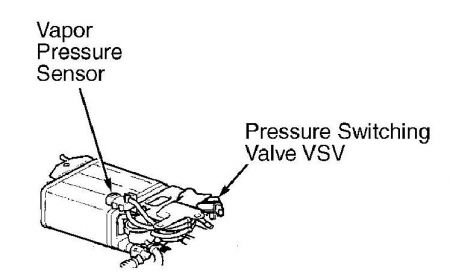

P0446 = EVAP vent control circuit. The diagnostic procedure is rather lengthy and I would suggest you try the folowing first before going to diagnostics. At rear there is the pressure switching valve VSV. Check if it is bad.
https://images.2carpros.com/forum/automotive_pictures/192750_VSV_1.jpg
Aug 26, 2010 at 7:00 AM
LISZT85
  • 26 POSTS
Two questions:
1) Where on the car is the valve (by "rear", what do you mean exactly)? What tools do I need to get there?
2) How do I check if its bad? Just a visual inspection? IF so, what do I look for?

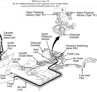

It is located on bracket at charcoal canister near fuel tank and contains 2-pin electrical connector with Violet and Black/Yellow wire.
https://images.2carpros.com/forum/automotive_pictures/192750_EVAPFuelTankComp00CamryFig142a_1.jpg
Look out for broken wires, damaged valve or diasconnected/contaminated wire couplers. Don't feel bad about not knowing anything about cars. It is never too late to learn and the best way to learn is to ask.
Aug 26, 2010 at 9:25 AM

I went ahead and got engine diagnostics done at the local mechanic's. Here are the results and the estimates that I received. Please tell me what you think..
He says that the oil seals are leaking oil and that the water pump seems to be leaking a bit. He also told me that the back tires are cupping and that it means just one thing: the rear struts are bad and need to be replaced.
The CEL is on and will go away if the closed vacuum switching valve is replaced and the sway bar links on two sides need to be changed but these, he said, aren't crucial but the water pump, seals and the struts are crucial and need to be changed before the winter. He also tells me that its better to use the green coolant because the red one eats into the water pump due to its acidic nature and so he recommends a cooling system flush to replace it with the green stuff and he says that the red coolant is responsible for the water pump leak. Here are the estimates:
