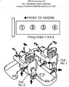

If I am correct on the 1999 Camry four cylinder the longest spark plug wire's end goes to the closest connection to the front of the car and the other follow to the back. Am I correct?
Also, where is the ignition coil? I appreciate your help.
Sep 5, 2009 at 1:40 PM
KHLOW2008
  • CAR REPAIR CONTRIBUTOR
  • 41,814 POSTS
Here is a diagram of the ignition coils and the firing order.
https://images.2carpros.com/forum/automotive_pictures/192750_FiringOrder99CamryFig02_1.jpg
