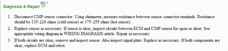

It come this code, and when at toyota dealer tells me it does not have a cam sensor, they did not come out on that engine until 1998 and mine is a 1996. How do u bypass this?

What it could mean is one of the parts in the distributor is causing the fault...
https://www.2carpros.com/forum/automotive_pictures/62217_340a_1.jpg
https://www.2carpros.com/forum/automotive_pictures/62217_340b_1.jpg
