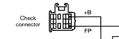

Why won't the fuel pump engage.
Monday, May 31st, 2010 AT 7:44 PM
MHPAUTOS
  • 31,937 POSTS
You will have to get the power at the pump check, often it is a failed fuel pump, you can do a quick test by bridging out terminals B+ & FP at the check connector under the bonnet this will power up the pump direct, if it will not run the pump is faulty.
