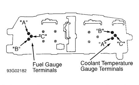

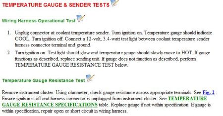

I have replaced the radiator and thermostat, flushed the system, checked all the hoses and fans. I replaced the temp sending unit and the gauge still goes to full hot. Is the engine control module the only thing left?

If you are certain the gauge is reading inaccurately and the sending unit has already been replaced then it is most likely the gauge itself at fault.
https://www.2carpros.com/forum/automotive_pictures/261618_Noname_879.jpg
https://www.2carpros.com/forum/automotive_pictures/261618_Noname2_230.jpg
FIG. 2
https://www.2carpros.com/forum/automotive_pictures/261618_2_60.jpg
