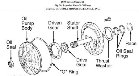

Here is an exploded view of the oil pump. It is just behind the torque converter.
https://www.2carpros.com/forum/automotive_pictures/192750_TransOilPump93Camry_1.jpg
As DocFixit had mentioned. Loosen the trans to engine holding bolts and get the trans to back away from the engine. Remove the transmission rear mount first and use a jak to support the trans so that it is not slanting and pressing against the drive plate. Once you have sufficient clearance. try to turn the torqueconverter, lifting it slightly to get it aligned to slot into the oil pump,
If there are any oil leakages from behind the torque converter, the oil pump has been damaged. You would have to remove the transmission to check the amount of damage.
You can use an oil pump from a donor trans that is similar.
