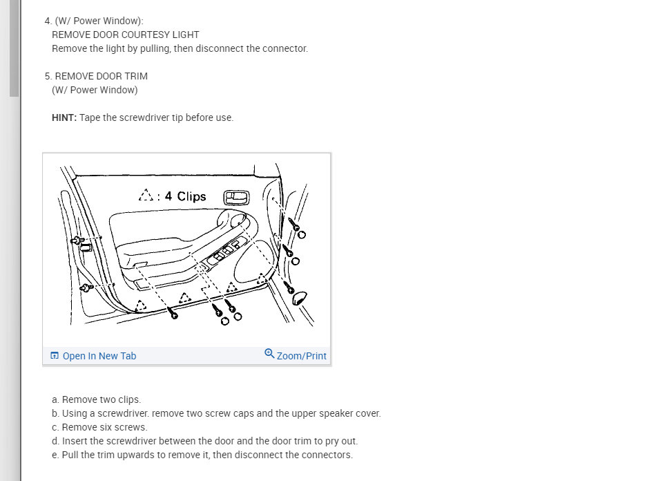

My driver door no open from out side ho inside not open at all
Saturday, October 9th, 2010 AT 5:25 PM
If the door is stuck and will not open from the inside or outside, then the latch is stuck.

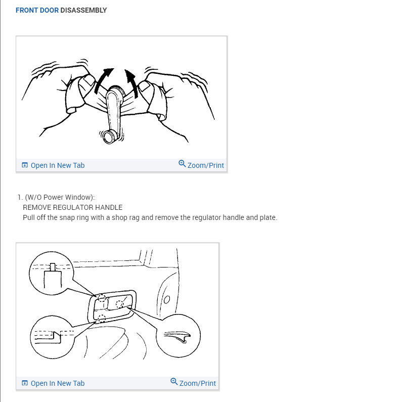

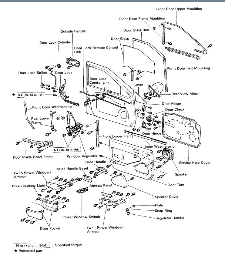

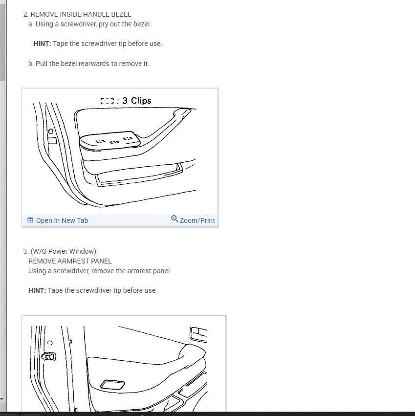

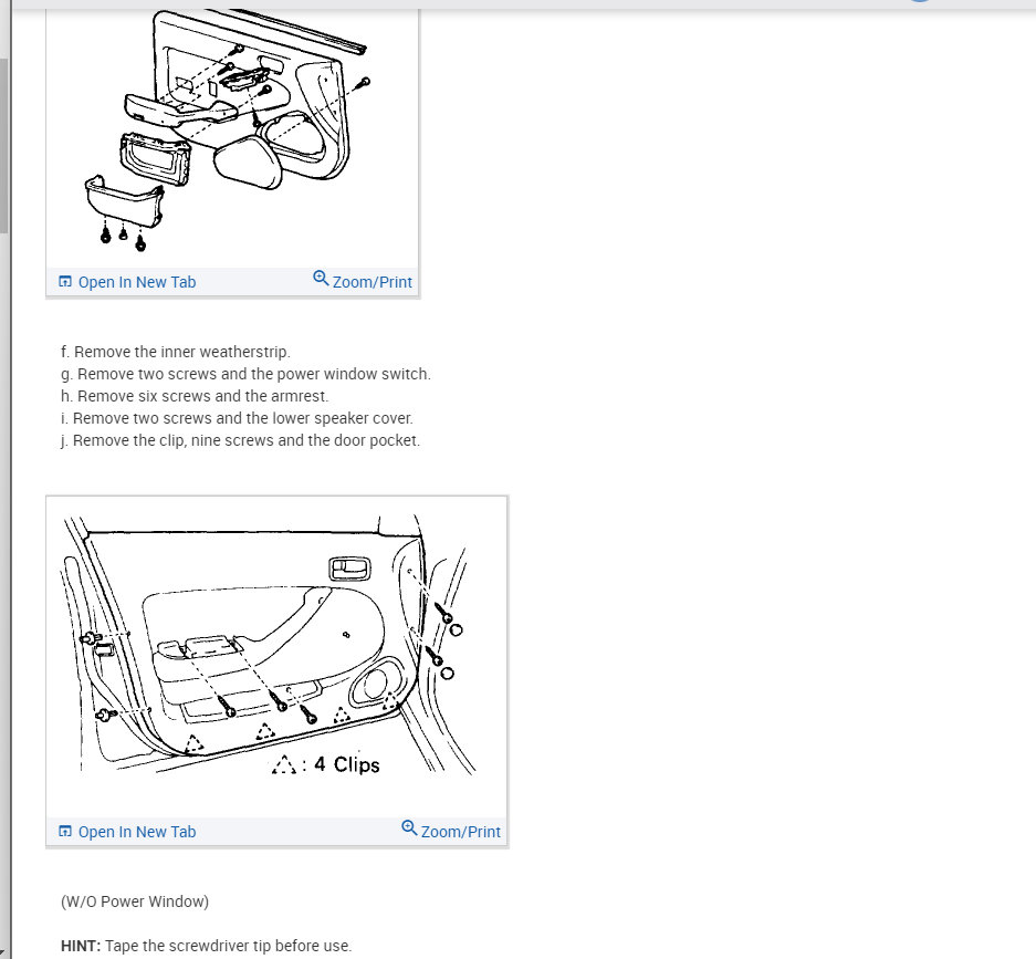

This means we need to try a couple things. First, we need to pull the handle and see if there is any resistance. If not, then the rod inside the door has fallen off.
If this is the case, then we have no option but to try and remove the interior door panel so that you can manually open the latch. Then you will be able to open the door and replace the latch.
Here is a guide that will help with doing this. Clearly, we are going to have to try and do this with the door closed so it will not be as easy but can be done.
https://www.2carpros.com/articles/door-panel-removal
Please run through this info and let us know if you have more questions.
