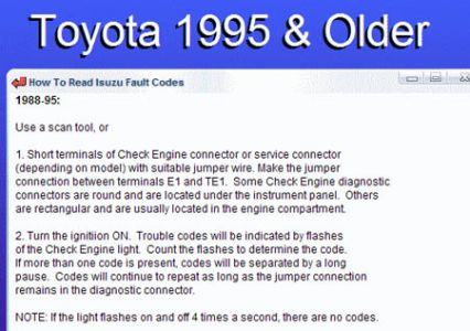

I have a 91 toyota camry. The thing used to run great. About a week ago, I went to leave and started it. It started but immediately ran rough and then died. The same day I did a tune up on it. It didn't get any better. It would take 5-6 times of cranking it over and it would stay running but idle very rough. It you let it warm up, it runs like a champ. A shop told me it was getting to much fuel and flooding itself. I replaced the fuel pressure regulator and it didn't take care of it. What else should I check?

Check the cold start injector time switch, and read the codes...may be something stored in the computer's memory...
https://www.2carpros.com/forum/automotive_pictures/62217_95AndOlder2_5.jpg
https://www.2carpros.com/forum/automotive_pictures/62217_95AndOlder1_3.jpg
https://www.2carpros.com/forum/automotive_pictures/62217_95AndOlder3_6.jpg
https://www.2carpros.com/forum/automotive_pictures/62217_ColdStart_1.jpg

A few weeks ago when this all started. I used my multimeter and checked the ohms on the cold start injector valve. My repair manual said between 2 and 4 ohms. That is what I got on the meter. Then today I noticed All Data said 24 ohms. I decided to remove the valve and noticed that it had massive dirt and build up on it on the inside. I sprayed it off with carb cleaner and re-installed it. The vehicle fired right up and runs like a champ again. :D
