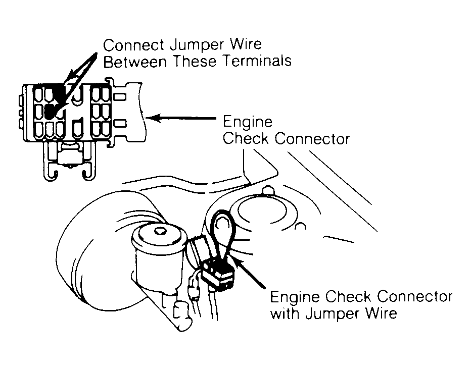

  • CAR REPAIR CONTRIBUTOR
  • 75,992 POSTS
Pull the DTC/s from the computer by jumpering the Te-1 to E-1 in the check connector and comeback with it-also might want to check and monitor the fuel pressure when it acts up-check the idle air control valve and throttle position sensor.
