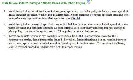

Is there a simple way to time this engine while installing a new timing belt?

FIGURE 14
