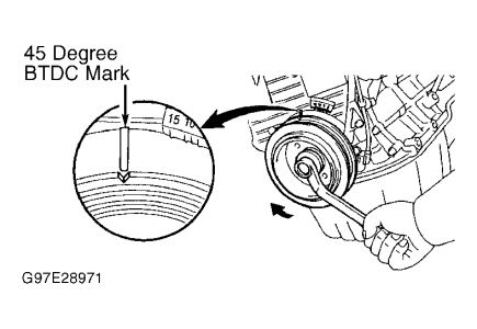

My timing belt broke so I bought a new belt and I am trying to time the crankshaft to the camshaft, but I still do not have it right. How is it supposed to be timed? Yeah. If you could give me a step by step instruction that would be great. I have never done this before.

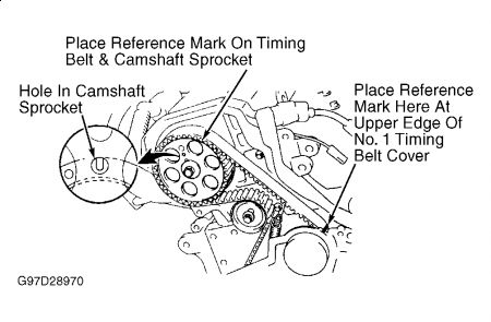

Here is a guide and the instructions below:
https://www.2carpros.com/diagrams/toyota/camry/1995

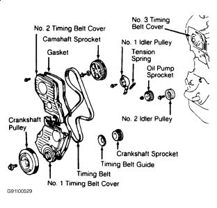

Remove Number two timing belt cover and gaskets. See Figure.
https://www.2carpros.com/forum/automotive_pictures/99387_Graphic1_570.jpg
Rotate crankshaft clockwise so cylinder number one is at TDC on compression stroke. Cylinder number one is front cylinder at timing belt end of engine.
Ensure timing mark on crankshaft pulley aligns with "0" mark on number one timing belt cover. Ensure hole in camshaft sprocket aligns with alignment mark on camshaft bearing cap. See Figure.
https://www.2carpros.com/forum/automotive_pictures/99387_Graphic3_125.jpg
. If hole in camshaft sprocket is not aligned with alignment mark, rotate crankshaft clockwise one full revolution.
CAUTION: If reusing timing belt, mark direction of timing belt rotation on belt. Place mating marks on timing belt at camshaft sprocket and at crankshaft sprocket for reassembly reference. Also place reference mark on timing belt at upper edge of number one timing belt cover. See Figure.
https://www.2carpros.com/forum/automotive_pictures/99387_Graphic3_126.jpg

Remove timing belt from crankshaft sprocket. Remove idler pulleys (if necessary).

Install number one idler pulley and tension spring (if removed). Pry number one idler pulley away from timing belt area as far as possible. Temporarily tighten number one idler pulley bolt. Ensure idler pulley is clean and rotates smoothly.

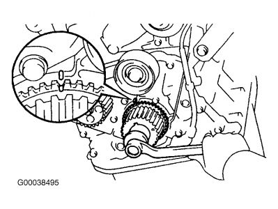

Using crankshaft pulley bolt, rotate crankshaft so timing mark on crankshaft sprocket aligns with timing mark on oil pump housing. See Figure.
https://www.2carpros.com/forum/automotive_pictures/99387_Graphic3_127.jpg
This will position key-way in crankshaft sprocket at 12 o'clock position.
CAUTION:If reusing timing belt, ensure reference marks on timing belt align with reference marks placed on crankshaft and camshaft sprockets.

Ensure all sprockets and idler pulleys are clean. Install timing belt on crankshaft sprocket, oil pump sprocket, number one idler pulley, and then number two idler pulley in sequence.
Install timing belt guide with cupped side away from crankshaft sprocket and flat side toward timing belt. Install number one timing belt cover and new gasket.
Ensure timing mark on crankshaft pulley aligns with "0" mark on number one timing belt cover. If reusing timing belt, ensure reference mark on timing belt aligns with upper edge of number one timing belt cover.
Rotate camshaft, and align hole in camshaft sprocket with alignment mark on camshaft bearing cap.
Install timing belt on camshaft sprocket.
If reusing timing belt, ensure reference mark on timing belt aligns with the reference mark on camshaft sprocket.
Ensure tension exists on timing belt between the crankshaft and camshaft sprockets.
CAUTION: Do not rotate crankshaft counterclockwise, as viewed from timing belt end of engine.
Loosen number one idler pulley bolt half turn. Rotate crankshaft pulley two full revolutions clockwise from TDC to TDC.
Ensure timing mark on crankshaft pulley aligns with "0" mark on number one timing belt cover, and hole in camshaft sprocket aligns with alignment mark on camshaft bearing cap
If timing marks are not aligned, remove timing belt and reinstall.
Rotate crankshaft clockwise 1 and 7/8 revolutions and align crankshaft pulley "0" mark with forty five degree before top dead center (BTDC) mark on number one timing belt cover.
See Figure.
https://www.2carpros.com/forum/automotive_pictures/99387_Graphic4_56.jpg

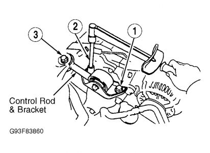

Install all bolts/nuts on right (timing belt side) engine mount before tightening to specification.
On Camry, when installing control rod and bracket on strut tower and right (timing belt side engine mount, tighten bolts to specification in sequence.
https://www.2carpros.com/forum/automotive_pictures/99387_Graphic5_34.jpg
