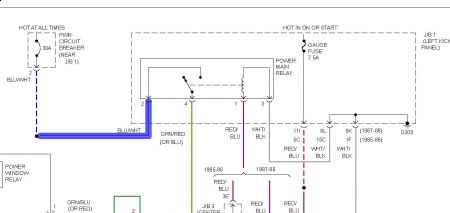

My 88 camry do not have electrical power tomy driver side door I mean no power window or power door lock at all how do I check it out ( fuse or etc.) Thanks

Check the power circuit breaker,power window relay and power main relay see below
https://www.2carpros.com/forum/automotive_pictures/12900_88_camry_window_and_lock_EWD_2.jpg
