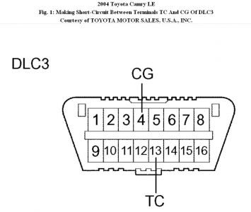

2. By using SST (diagnosis check wire No. 2) ( a paper clip would do as well), make a short-circuit between terminals TC (13) and CG (4) of the DLC3.
NOTE:
Do not make a short-circuit in any other positions.
https://www.2carpros.com/forum/automotive_pictures/192750_DLC3Camry04Fig01_1.jpg

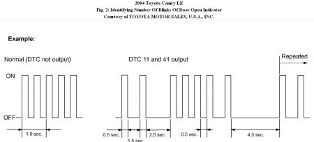

3. Turn the ignition switch ON and read the number of blinks of the door open indicator.
HINT:
When 2 or more codes are output simultaneously, display will be started from the smaller numbered code.
https://www.2carpros.com/forum/automotive_pictures/192750_DTCreadingSample01_1.jpg
4. When the DTC of the ECU unconnected is displayed, perform an inspection depending on the troubleshooting.
HINT:
"Â When the communication bus is defective the door open indicator in the meter will not be on and therefore any DTC will not be output.
"Â When other DTC is output, refer to the DTC table and applicable section.
"Â When no DTC is output even in the normal condition, problems, such as short-circuit between terminals TC and CG, meter fuses defective etc., may exist.
"Â When the door open indicator is always on, the wire harness might be short-circuited.
