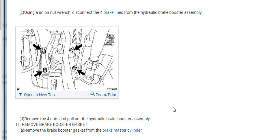

I had my brakes done at 70000 miles by Brakes Plus. I scored the right rotor very badly but Brakes Plus said they could machine it but it was close. After 10000 miles I have developed a hissing under the dash they say my booster is bad. thanks in advance.
Apr 8, 2009 at 7:58 PM
  • CAR REPAIR CONTRIBUTOR

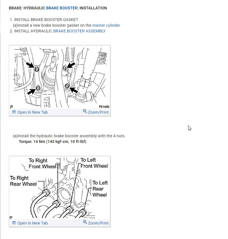

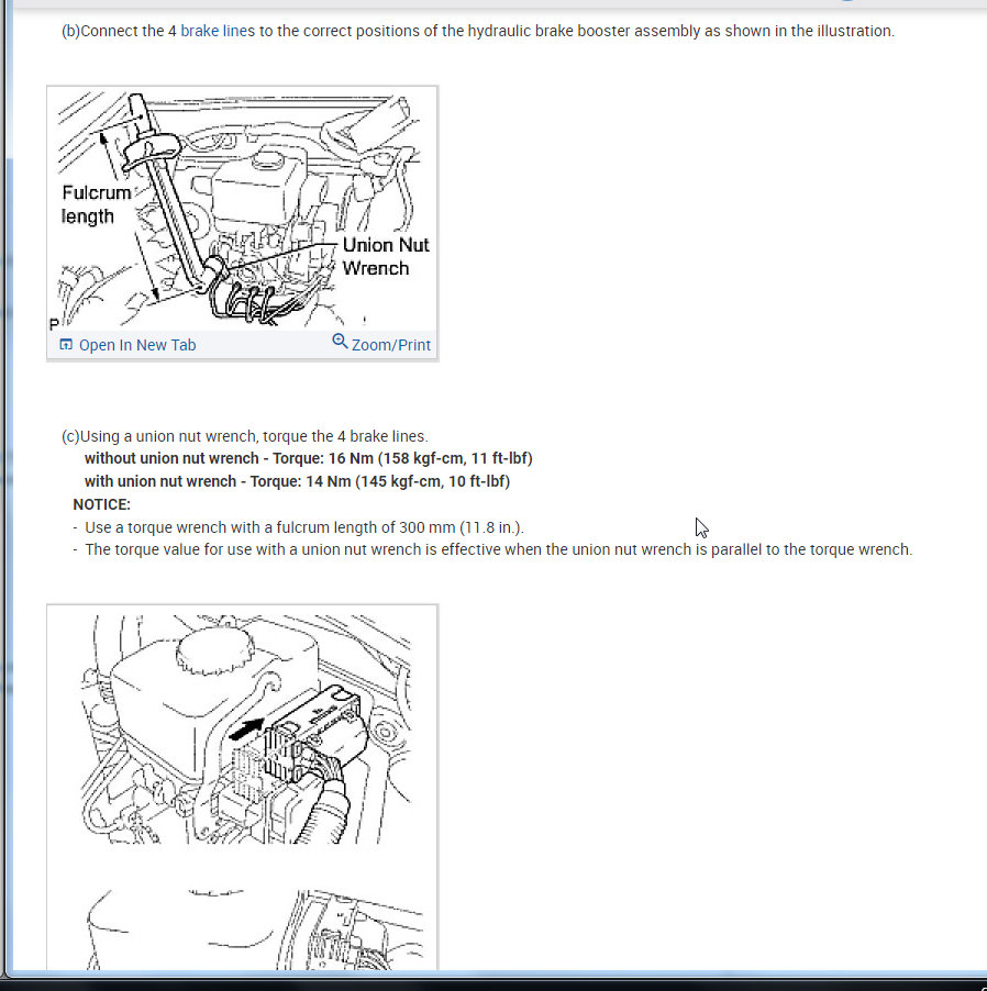

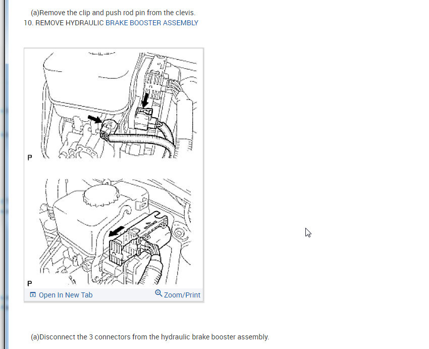

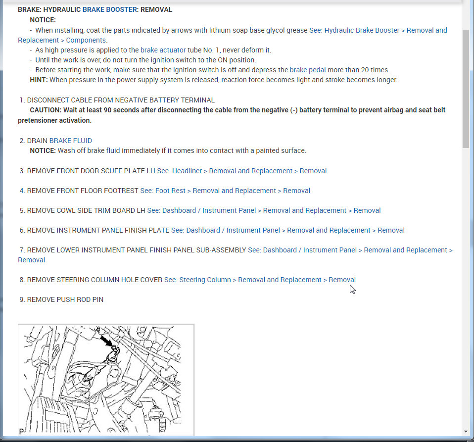

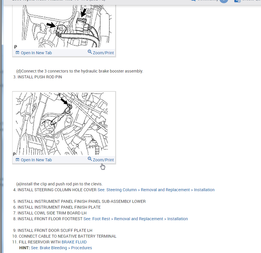

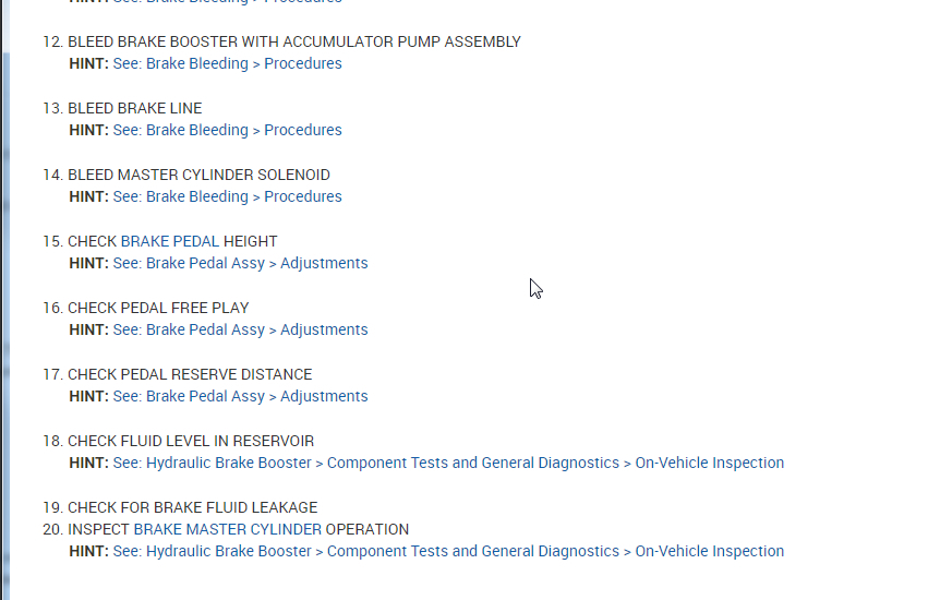

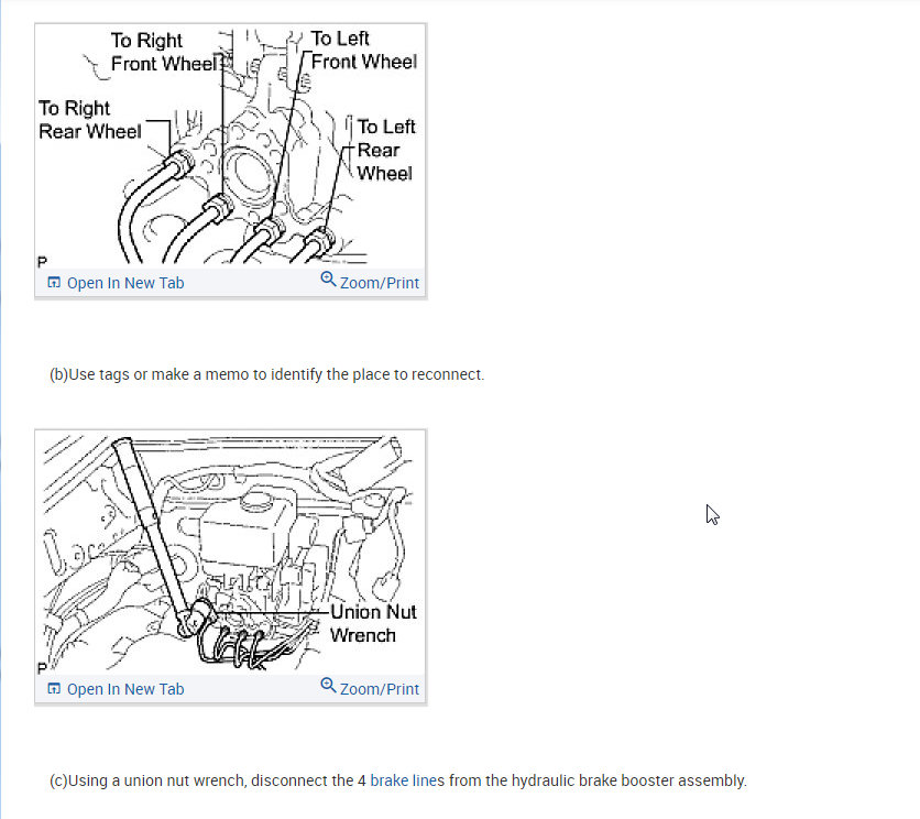

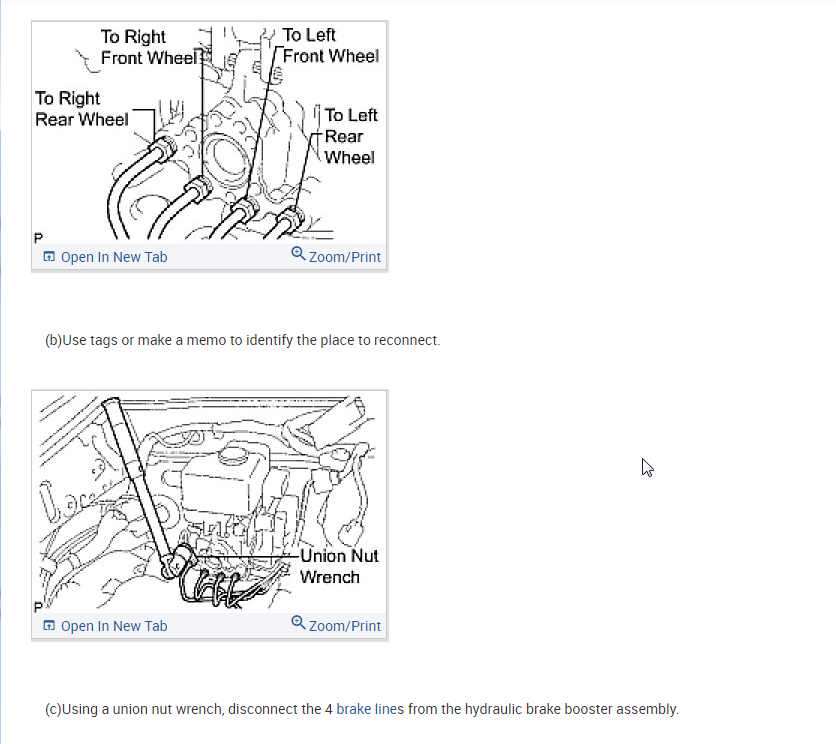

Yes. Normally a hissing is a brake booster so I attached the instructions below on how to remove and install it.
Also, here is a guide that will help with how to bleed the brakes as that will need to be done as well:
https://www.2carpros.com/articles/how-to-bleed-or-flush-a-car-brake-system
Please run through this material below and let us know if there are other question. Thanks
