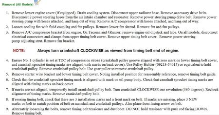

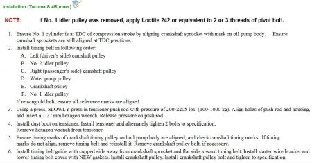

Engine Mechanical problem
2002 Toyota 4Runner 6 cyl Two Wheel Drive Automatic
looking for step by step instructions and some pictures or diagrams for timing belt replacement. No I do not have a repair manual. Thanks for your reponse
