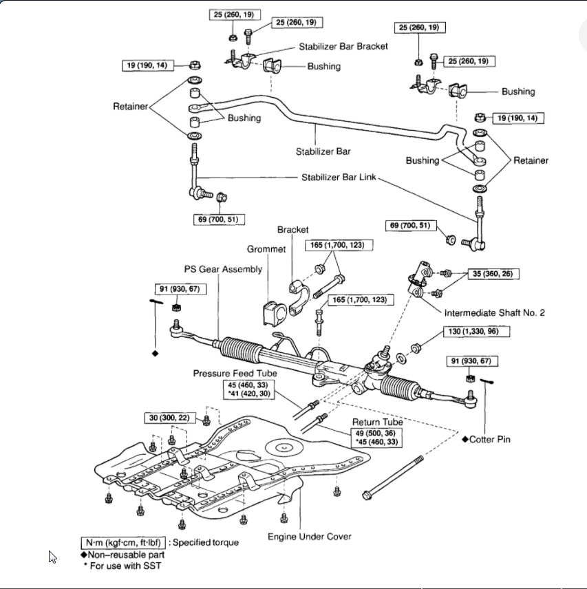

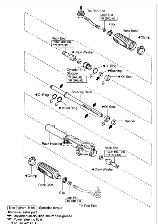

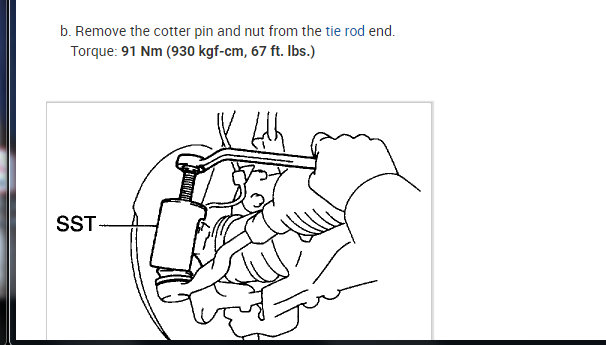

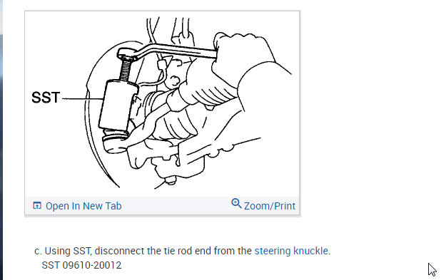

My owner's manual does not tell me how to replace the tie rod ends
Sunday, November 30th, 2008 AT 6:57 PM
MECHANIC
18,907 POSTS
Unfortunately the owners manual does not supply this type of information.
Here is a guide that will help with this:
https://www.2carpros.com/articles/tie-rod-end-replacement
Plus below is the info from the manual that will give the info needed. Please let us know if you need more info. Thanks
