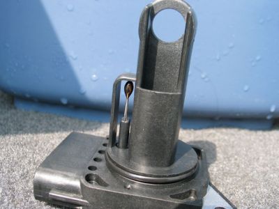

FISHERMAN
  • 937 POSTS
Here`s how to clean the MAF sensor:
use a brake cleaner. "does not leave a film or residue". do not use a qtip because you don't want to physically touch the MAF and risk getting any pieces and strands of qtip getting stuck to the temp. sensor and the 2 hidden wires that are inside the MAF Sensor.
Do it with care!

BORGS8
  • 9 POSTS
Thanks F-man. I am on it. Hope the modest donation goes directly to you for all your help! Found it. The MAF looks very clean. The bulb is still brown and I can see the filament inside the glass. I shot some electronic contact cleaner in there though to avoid residue of brake cleaner. Sort of expected this though because I am religious about replacing air filter regularly with a Denso (no oil) filter. Now what? I am going to run to Auto Zone and get a diagnostic, even though CEL isn't on.

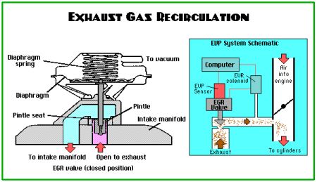

FISHERMAN
  • 937 POSTS
Hello !!
Did you got any "codes" on the scan ?
did you check the dist. cap?
What kind of spark plugs are you using?
did you replace them 30 k ago?
How about an EGR ?
An EGR clog Can cause a rough aceleration ..
But if stuck open a bad idling too....
And you have a good Idling...
check it anyway that way (process of elimination)..
https://www.2carpros.com/forum/automotive_pictures/576_egr_1.jpg
