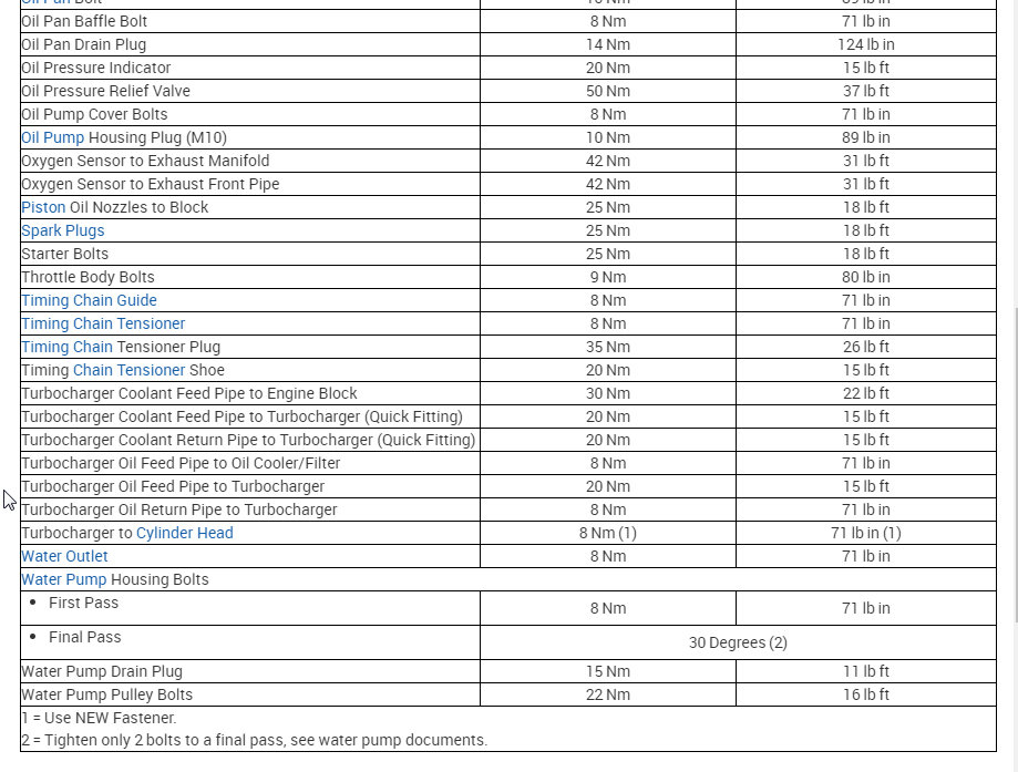

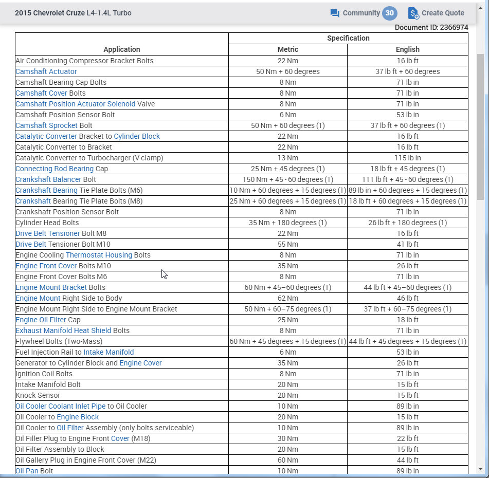

I need the torque spec and the tightening sequence for the valve cover. Thanks in advance!

I attached the entire engine torque specs in case you need something else.
FYI - They call this the camshaft cover bolts. First page, 4th one down.
Let us know if you need more info. Thanks

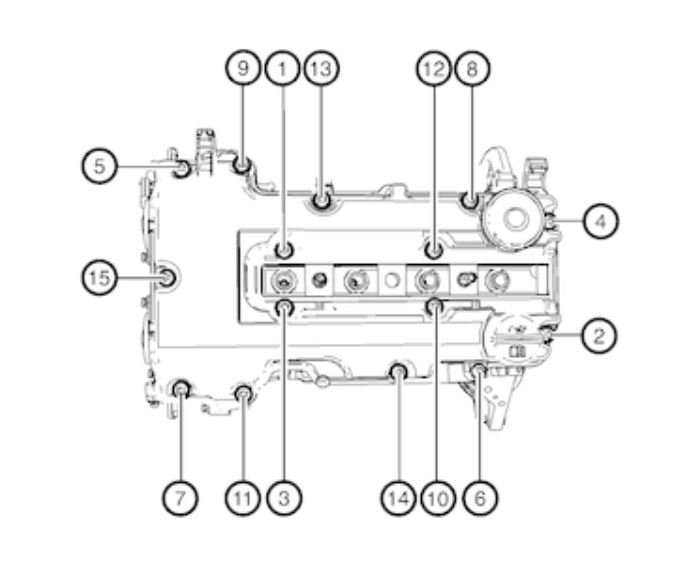

Thanks for the help KASEKENNY1. Does anybody have a diagram for the tightening sequence?

Good morning,
I had attached this before but it never showed up.
I posted the sequence below.
