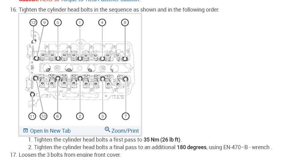

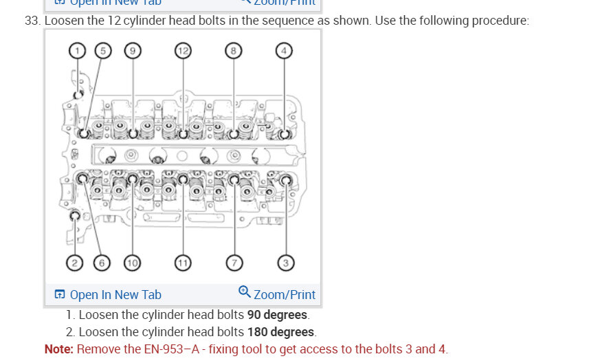

Hi, what is the torque pattern sequence on the cylinder head?

Here is how to loosen and tighten the cylinder head and be sure to check the sequence in the images below.
Images (Click to enlarge)
