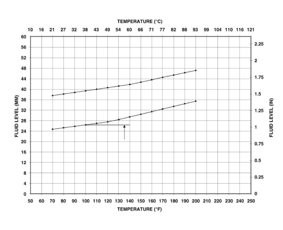

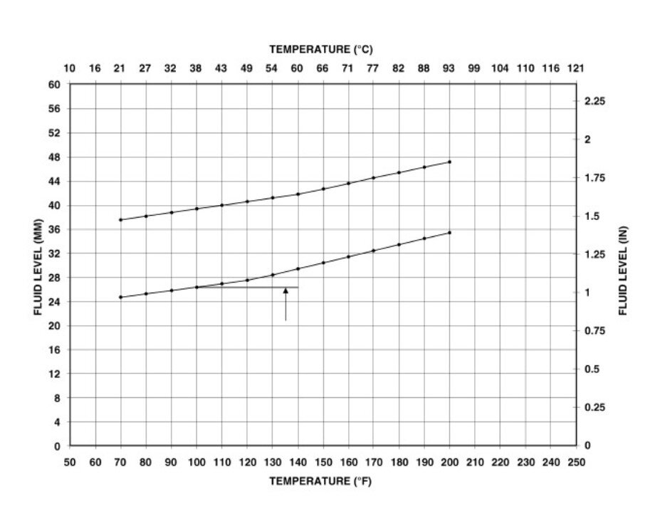

So I had a leak on my transmission the gasket was bad and I took it I drained it then took the pan off put a new one on there put it back together and I'm not sure how much transmission fluid I put back in because the internet says that the torque converter has a couple quarts in it and I took out a little bit more than five quarts so should I only put five quarts back in or what I bought a dipstick for the transmission and it's reading at 50mm and at 120 or 30° and it's supposed to be at 200° if it's at 50mm the dipstick says not 50 at 120 or 30° so I think it's overfilled?

There will always be some in the transmission and the cooler that doesn't drain out. To fill it you add some fluid, then run it to warm it up, then check the fluid level at the correct temperature.

In total it holds about 8 quarts of fluid for that car. Some hold far more. The reason to check it while it is running is so that you get a reading of the level while it is in use and most of the fluid is in the working parts of the transmission. If you check it with it shut off it will read high because all of the fluid in the passages, converter and systems drains back into the pan. If you filled it cold as soon as you start it and the pump pulls in the fluid it's very possible that it would not have enough fluid. In a transmission the fluid does a lot, it gets pressurized to operate the parts but it also lubricates the bearings and bushings and it also acts as a coolant.
Start it and run it through the gears, now with it idling check the level. Pull the stick, wipe it off and put it back. Check it. If it's to high remove some (being new fluid you could use an extractor that is clean and save the fluid).

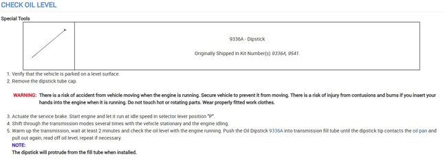

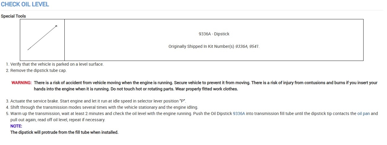

It can be a bear if it's overfilled. The fluid can get foamy and cause damage. Attached is the check procedure.

Thank you. Should the car be in park whenever I check it? Because some videos and some sites say that you need to have it in forward or reverse?

Park or neutral with the wheels blocked. The idea is that you run it to warm it up and circulate the fluids, so the various parts are filled. Then with it in park or neutral with the engine running the various parts are filled and the pan should only have the remainder and be full at the operating temperature. When the engine is then shut off and the fluid all drains out of components that are higher than the pan you would read it as overfilled. But the second you start the engine back up the fluid goes back into circulation and would now read as full again. It's intended to keep the transmission and cooler lines filled while in operation.
