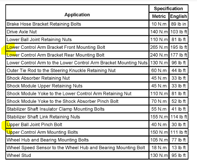

What is the torque for upper and lower arm bushings?

I attached the torque specifications for the entire front end. Note there are different specifications based on if the bolt is forward or rearward facing.
See pic below.
