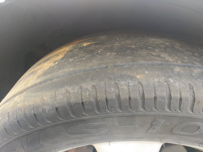

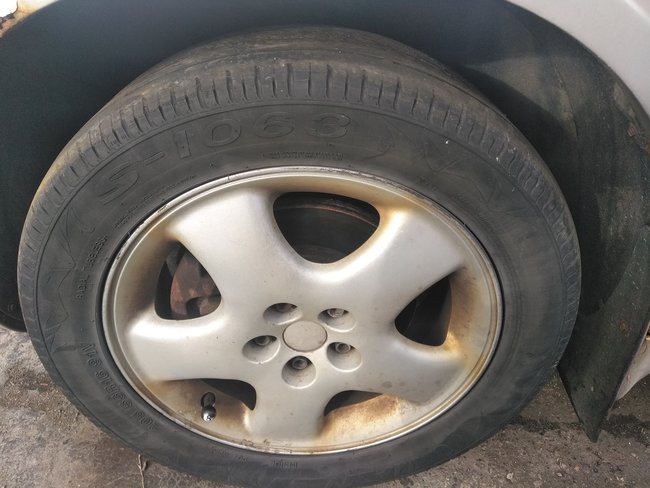

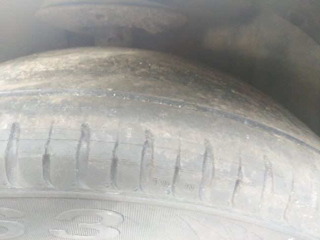

WILLIE26
  • 26 POSTS
Hello, i actually went outside today and had not checked all the tires yesterday! And clear as day i think i may have found the corporate. But not quite understanding as to why the tire would do this! Will post what pictures and video in second.
Jan 28, 2018 at 12:19 PM
HARRY P
  • CAR REPAIR CONTRIBUTOR
  • 2,292 POSTS
Yeah the tread is low on that tire, which made it a little weak. When you hit the bump, it appears that was enough force to break one of the aforementioned steel belts, which made your car ride badly. To confirm, put the spare on and take it for a ride.
Jan 28, 2018 at 7:26 PM
WILLIE26
  • 26 POSTS
Hello, left a tire shop i actually saw that my lower control arm is loose. Which is causing this loud noise and uneven wear in my tires.
Jan 28, 2018 at 7:32 PM
HARRY P
  • 2,292 POSTS
Oh boy you are lucky that thing did not come completely off while driving. I have been there in a mail truck. Not even a little bit fun. And very dangerous if it comes off at high speeds. Glad to hear you have a handle on it though. Just beware, the tire shop is likely going to try to sell you unnecessary work at a ridiculous price. Just have them do the bare minimum to make it safely driveable and then take it to a trusted independent mechanic and have them inspect it. They will generally give you an honest appraisal of the ball joints, control arm bushings, tie rods, and other such things.
