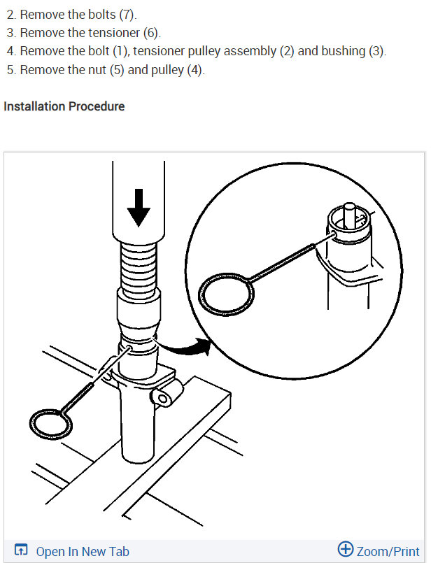

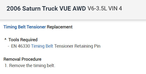

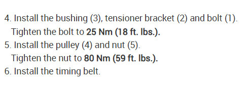

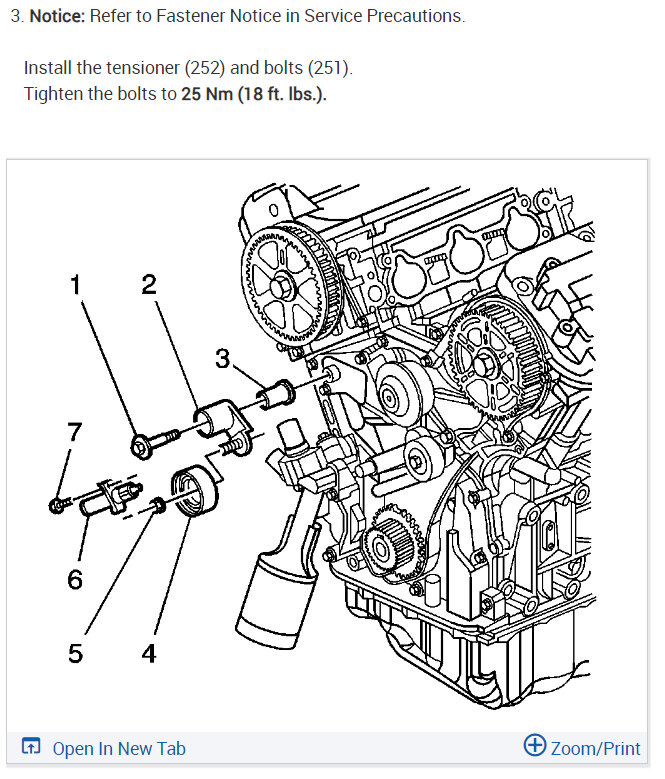

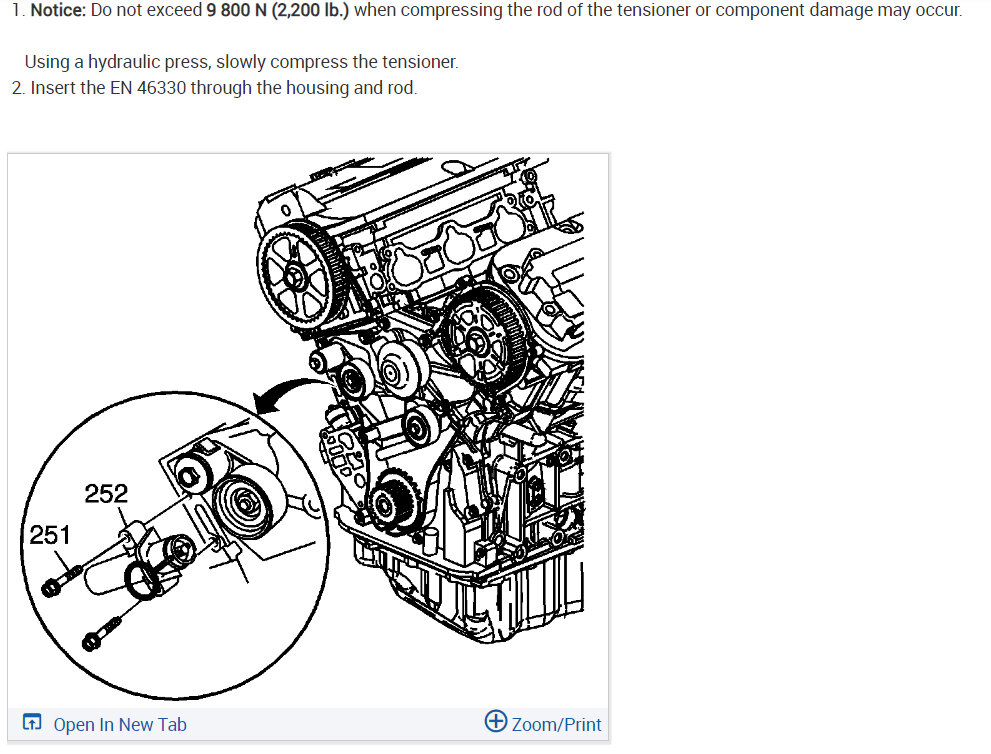

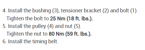

I would like the repair steps for replacing the timing chain tensioner please.
Sunday, October 13th, 2024 AT 8:09 PM
KEN L
MASTER CERTIFIED MECHANIC
55,291 POSTS
Sure, here are the instructions on how to replace the timing belt tensioner. Check out the images (below). Let us know if you need anything else.
