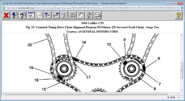

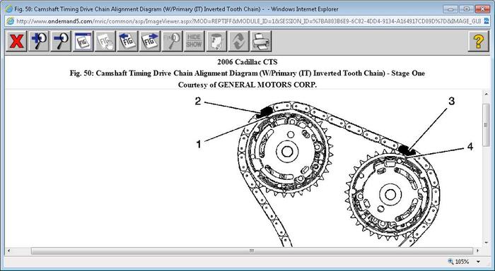

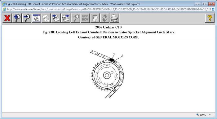

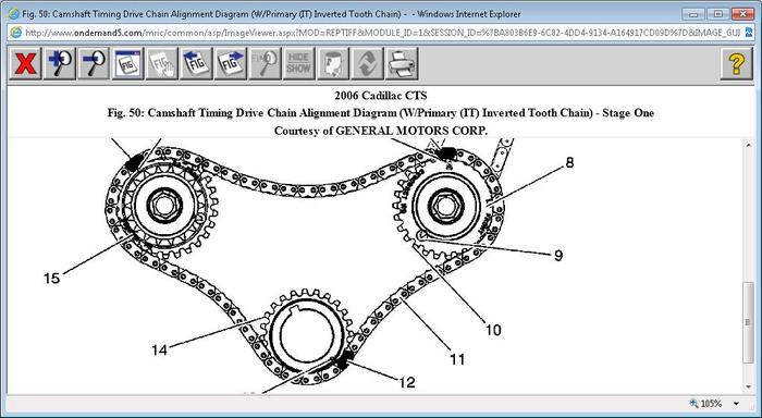

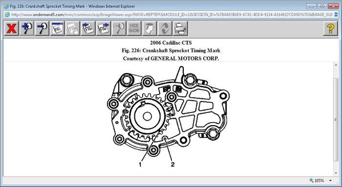

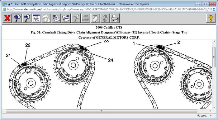

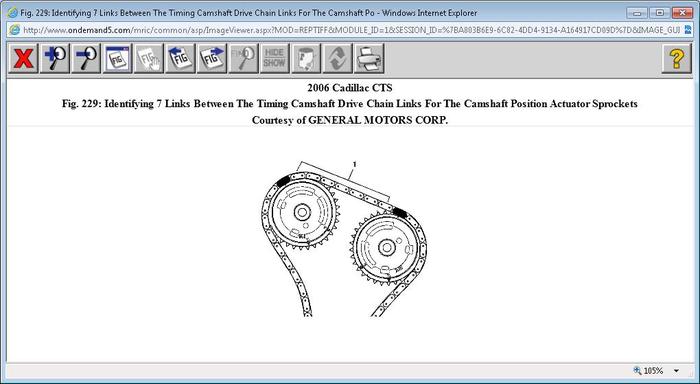

Can I get just a timing chain diagram for my car listed above it has 3.6l dohc engine?
Camshafts are out of sync.
Friday, October 18th, 2019 AT 2:27 PM (Merged)
SATURNTECH9
  • 30,869 POSTS
Here are the timing marks the left side marks along with the crank sprocket. There are more in the post below which should be able to get the job done.
+1
SATURNTECH9
  • 30,869 POSTS
The diagrams I just posted should get you there.
+11

In response to the question about the timing marks not lining up after turning the engine over manually, I had the same issue. I think it is due to the different number of teeth on the sprockets so that everything does't line up in the same spot every revolution. I followed the instructions for setting timing and made sure all the marks lined up, set the tensioners, and after turning engine manually none of the chain marks lined up anywhere. It made me kind of nervous but after reassembly the vehicle started right up and ran fine.
