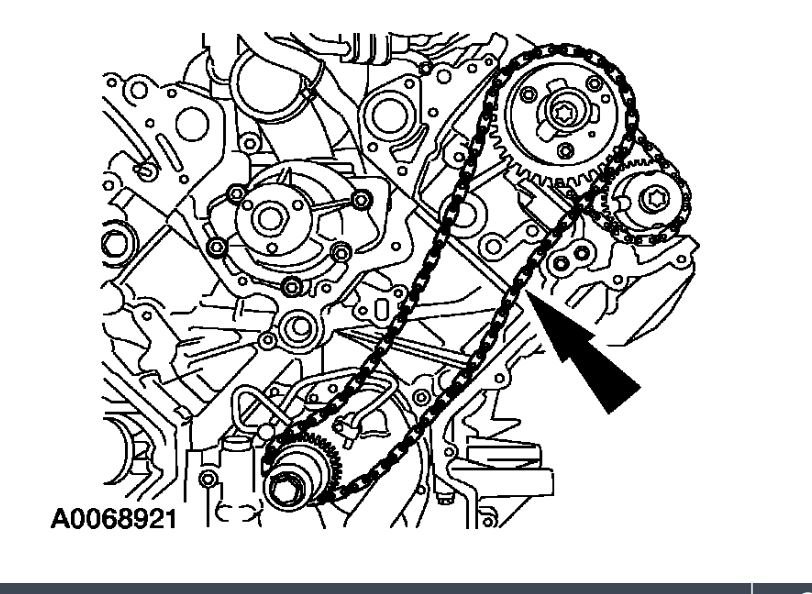

The timing belt skip time. Guy at shop say it would be better to replace engine than to do timing belt.
Tuesday, June 23rd, 2020 AT 8:09 AM
MECHANIC
52,796 POSTS
Good afternoon,
You have a timing chain.
Yes, this engine is what is called an interference engine. That would mean a very major repair.
https://www.2carpros.com/articles/how-a-timing-belt-works
It would be better to replace the engine with a good used engines.
