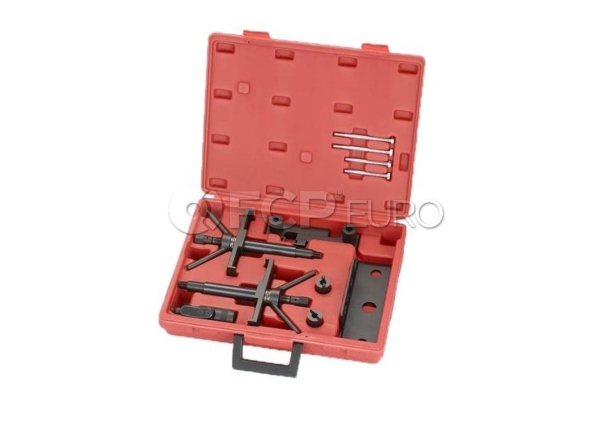

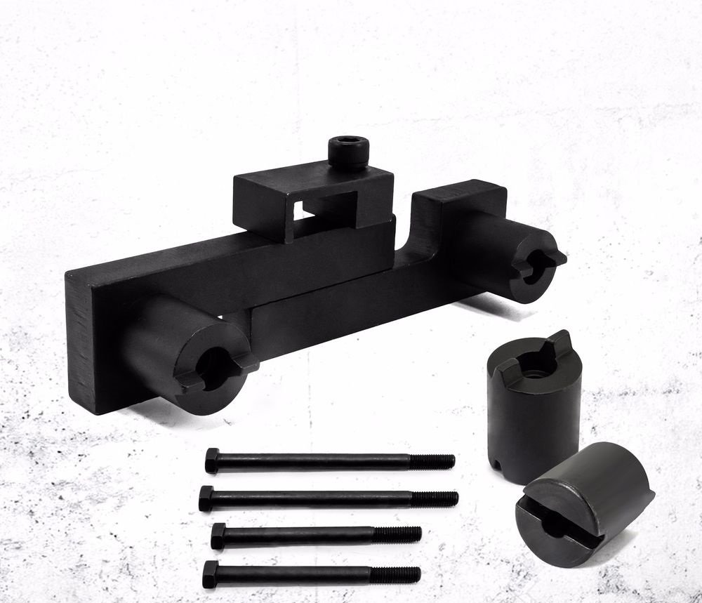

There are two tools required for this procedure. I attached them in this post. The procedure is below.
Since this is an interference engine, moving the cams and crank is critical to not move it. If you have to, move the crank gear about 90 degrees then no piston is at top dead center. Then you can move the cams into position.

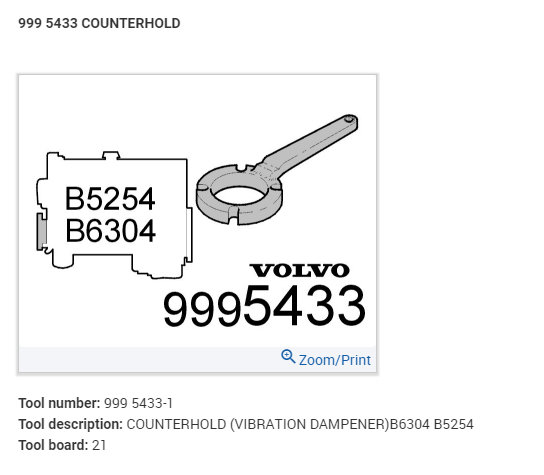

999 5433 COUNTERHOLD See: Vehicle > Electrical / Mechanical Repair > 999 5433 Counterhold

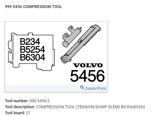

999 5456 COMPRESSION TOOL See: Vehicle > Electrical / Mechanical Repair > 999 5456 Compression Tool

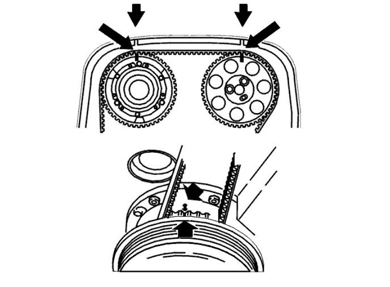

Turn the crankshaft clockwise until the markings on the crankshaft and camshaft pulleys correspond.
Turn the crankshaft a further 1/4 turn clockwise.
Then turn back counter-clockwise until the markings correspond.

Send images of the: 999 5433 COUNTERHOLD and 999 5456 COMPRESSION TOOL. Amazon yes/no?

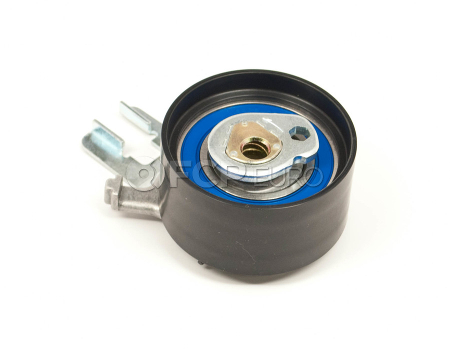

Wrong engine. I have a B6294T six cylinder-with Twin Turbo The tension-er unit described 999 5456 compression does not apply. The following images of the belt tension-er and tool is all should need with naturally a complete Volvo timing kit wit pump, gasket, idle pulley, tension-er, timing belt, serpentine belt, etc, etc. Please answer my original question without doing a cut and paste from justanswers.com
