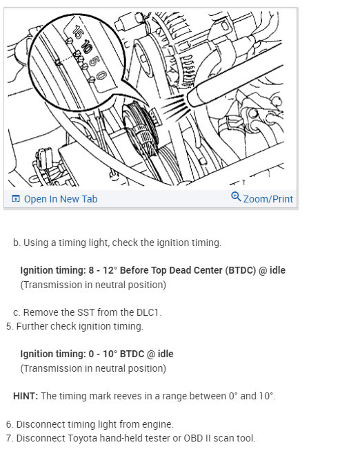

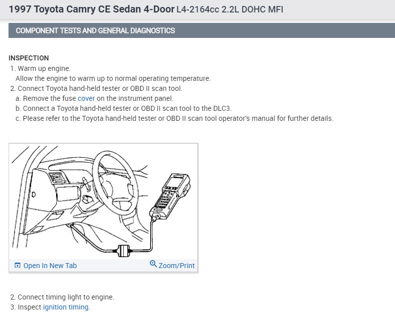

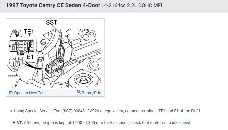

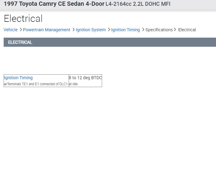

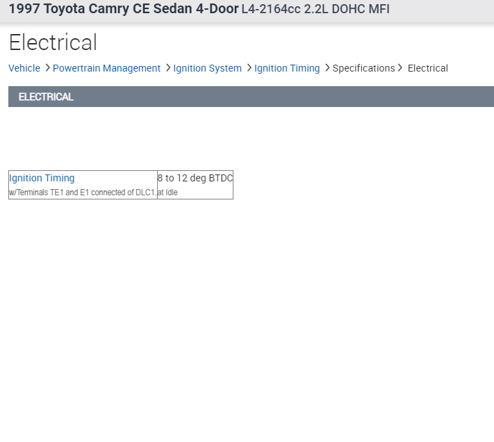

Ignition timing for this vehicle needed.

The timing for this 2.2L engine is 8 to 12 degrees before top dead center.
I have attached the procedure below for your reference.
Let me know of any questions.
