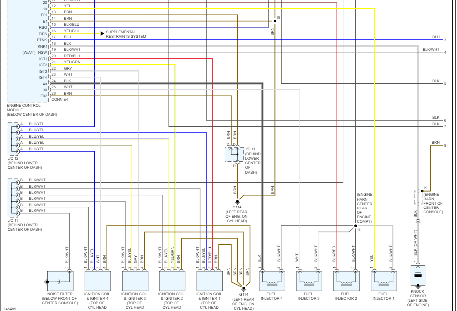

But please can I get the immobilizer to ECM wire diagram of this model to first check for open circuit and voltage test?
+1
Thursday, August 4th, 2022 AT 8:06 PM
  • 110,194 POSTS

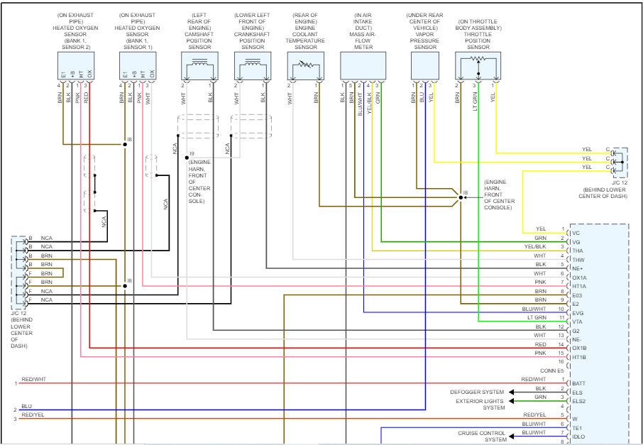

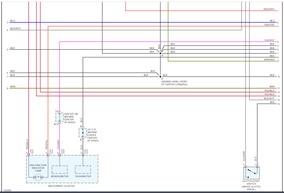

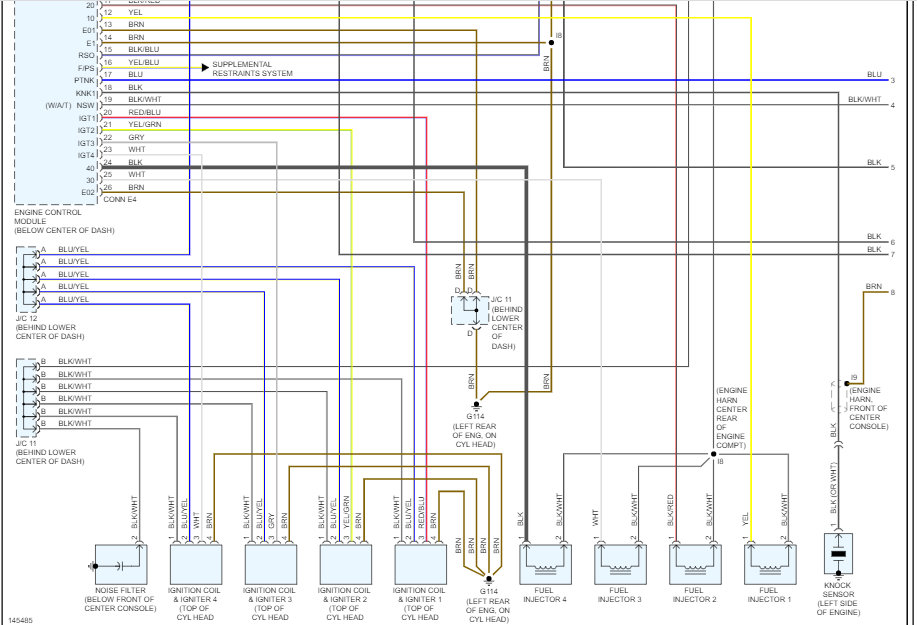

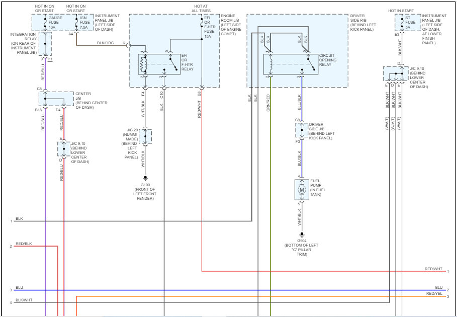

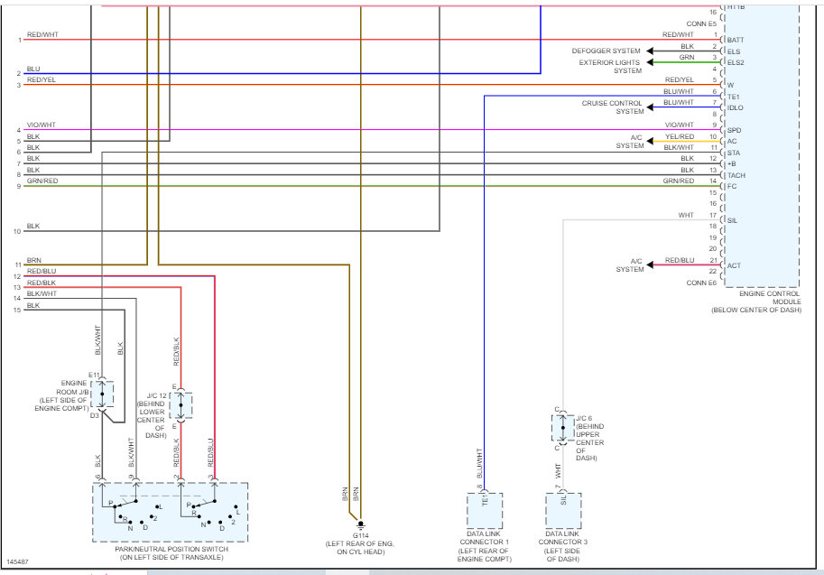

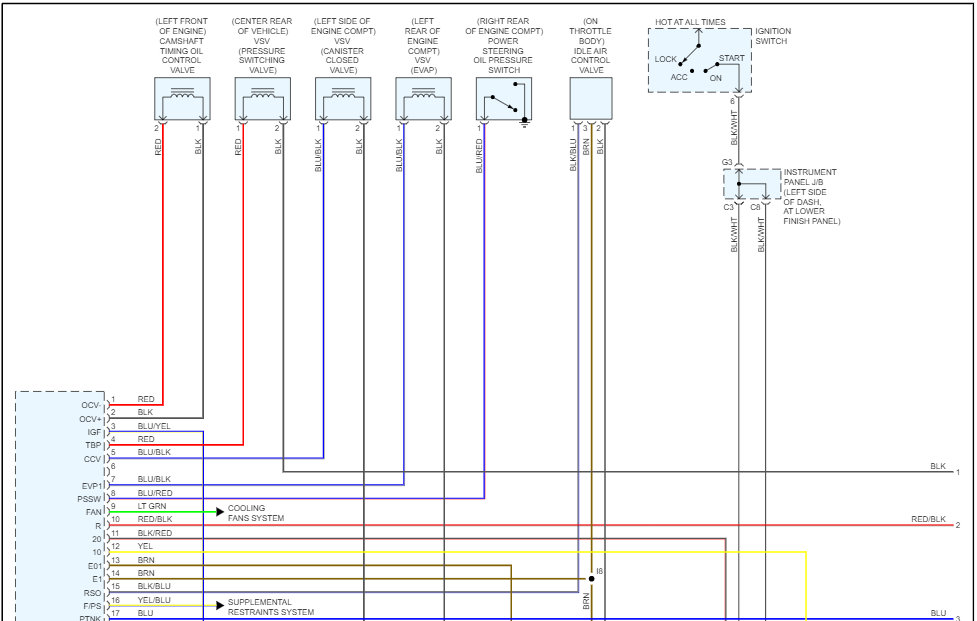

that is where I'm running into trouble. The code isn't listed for this specific vehicle. When I try to find wiring related to the immobilizer, nothing is available.
I would be happy to give them to you, but I can't find anything.
I did attach the schematics for the entire powertrain management system which should include what you are looking for, but it's not there.
See pics below. Note: There are three pages of schematics. I had to cut each one in half to make them readable. I did overlap them so you can follow from one to the next.
