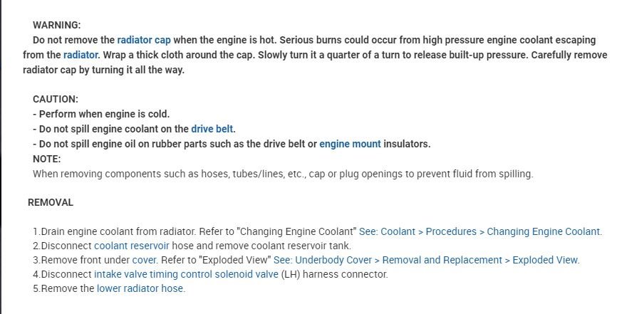

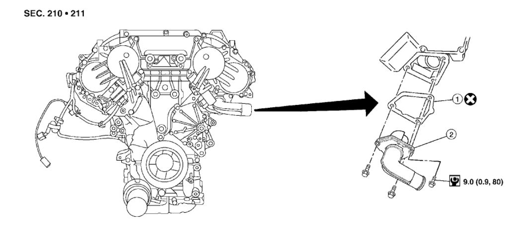

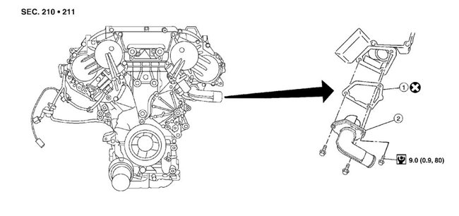

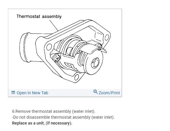

Hi, please can you help me out with the location of the thermostat, a diagram of DIY. Thanks.
Friday, November 12th, 2021 AT 1:46 AM
MECHANIC
52,796 POSTS
Good morning,
I attached the picture of the location for you of the location.
If you remove the lower hose, there is a 3-bolt housing by the outlet that contains the thermostat.
